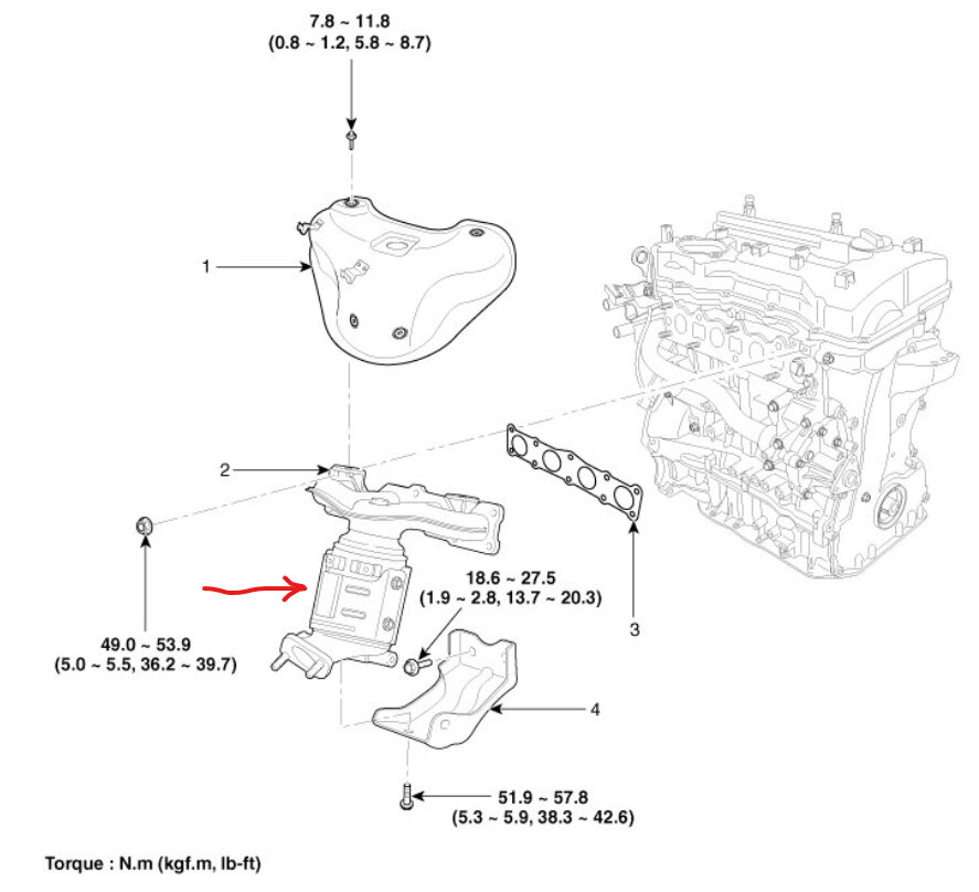

Engine light on, parts store scan showed P0420, cat.system efficiency below threshold bank one. Please enlighten me. The car runs good and no unusual sounds. It's a Santa fe sport. I'm glad ya'll are still around, I've been busy since my last contact, hope all's well over there.

P0420 - Catalyst System Efficiency Below Threshold (Bank 1)
This is pretty straight forward if you have no other codes, the catalytic converter is worn out and you need a new replacement. This car has 2 catalytic converters so the primary unit is the one you want to replace which is part of the exhaust manifold, here is the location and what the part looks like. Clear the codes once completed. Check out the images (below). Let us know if you need anything else.
