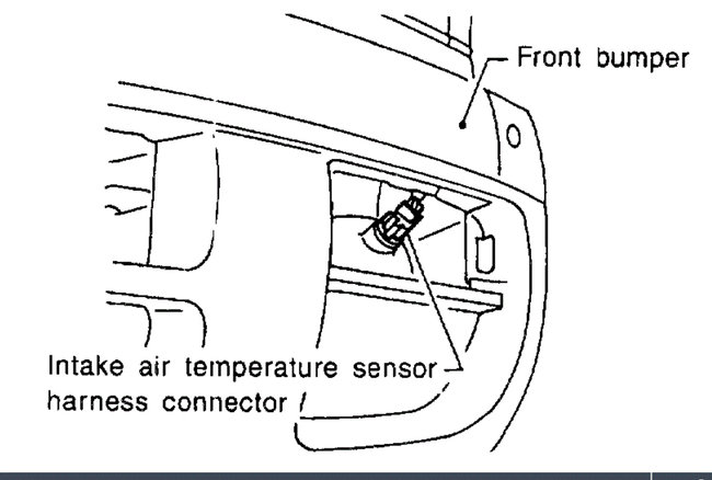

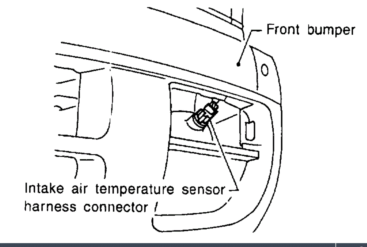

The IAT is located at the front bumper. Did you check there? See pic 1
As far as the fuses, I need the last 8 digits of the VIN number. Also, you indicated a vacuum leak at the intake. Is that the vacuum supply to the MAP sensor? Have you checked the catalytic converter for damage or restriction? When it is at 3500 RPM's, what happens? could it be the transmission slipping?
Keep in mind, if sensors have been removed, it becomes a guessing game as to what all was done, why it was done, and how they were bypassed.

Yes, I locate where the IAT sensor suppose to be, but someone eliminate that part totally with the resonator too.

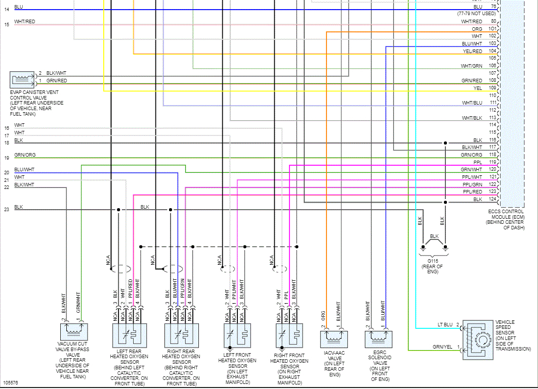

I need (if possible) the wiring diagrams for the IAT sensor, MAP sensor to make the proper connection circuit.

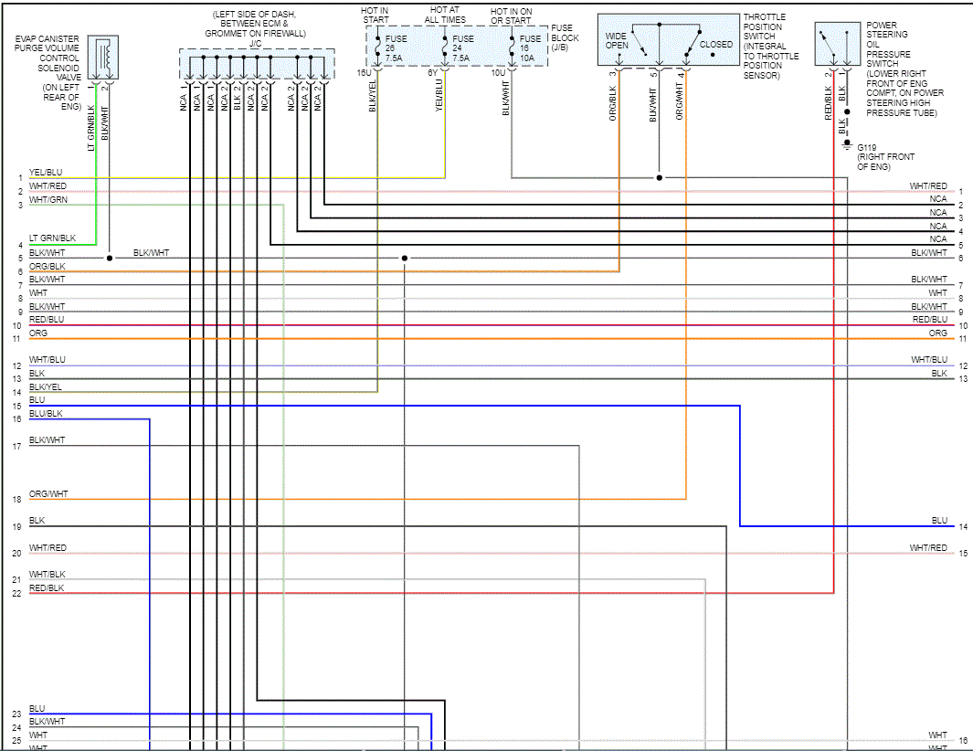

I ask you 2 more things, the distributor and or the TPS sensor in this pathfinder can cause the symptoms (problem) that I explain.

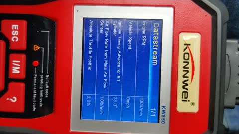

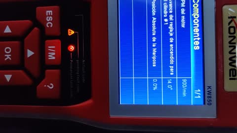

Here I send to you a video from my scanner taking live data from the rpm's, throttle position sensor and the timing (grades) of cylinder #1.
Other observations are welcome.
Thanks for the help,
Juan Marin.
Sunday, May 24th, 2020 AT 10:54 AM
  • 110,194 POSTS
The engine sounds good in the video. Are you sure the lack of power isn't simply the result of a slipping transmission?

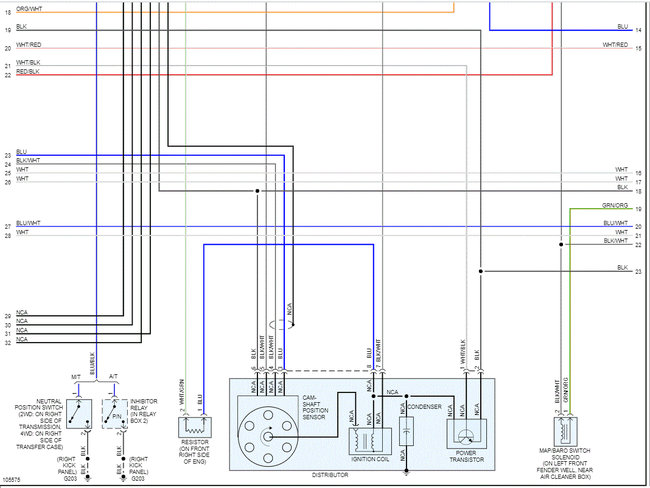

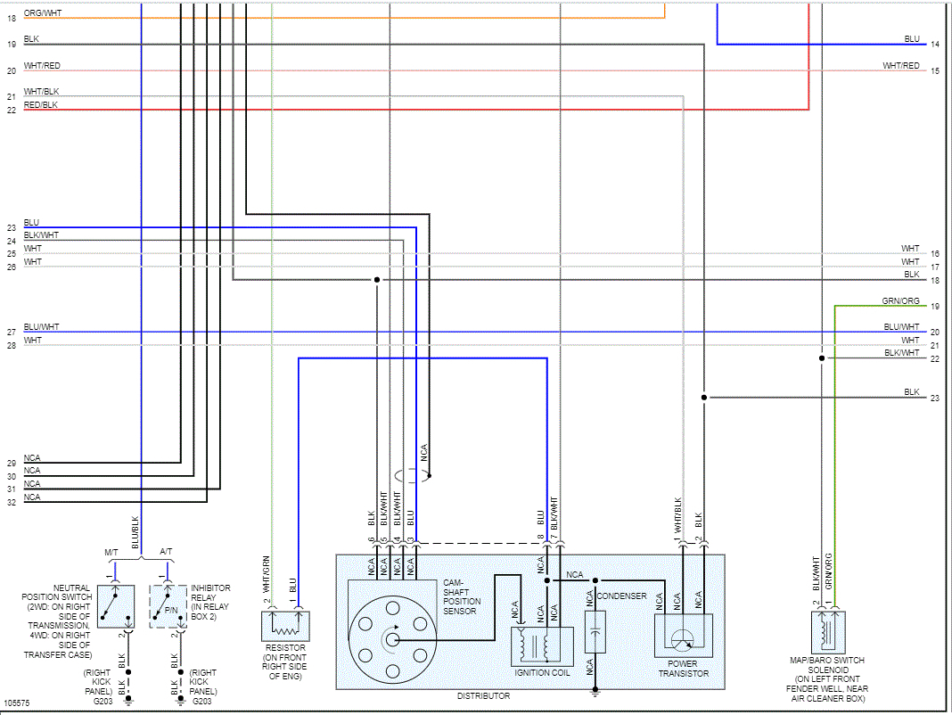

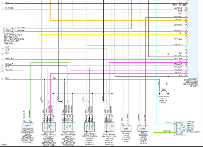

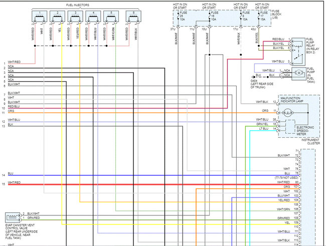

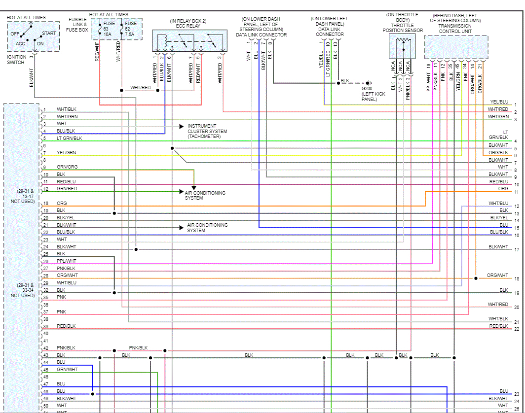

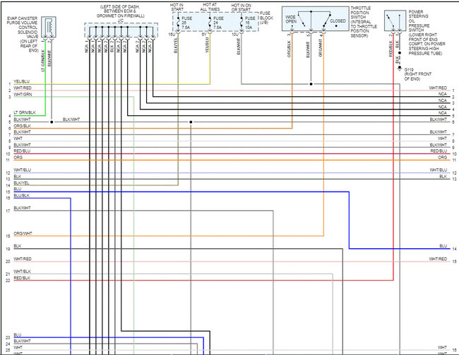

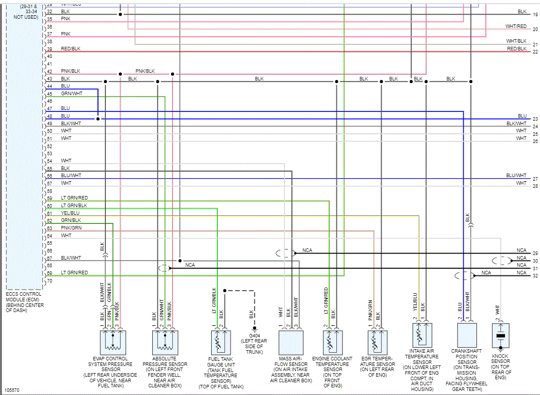

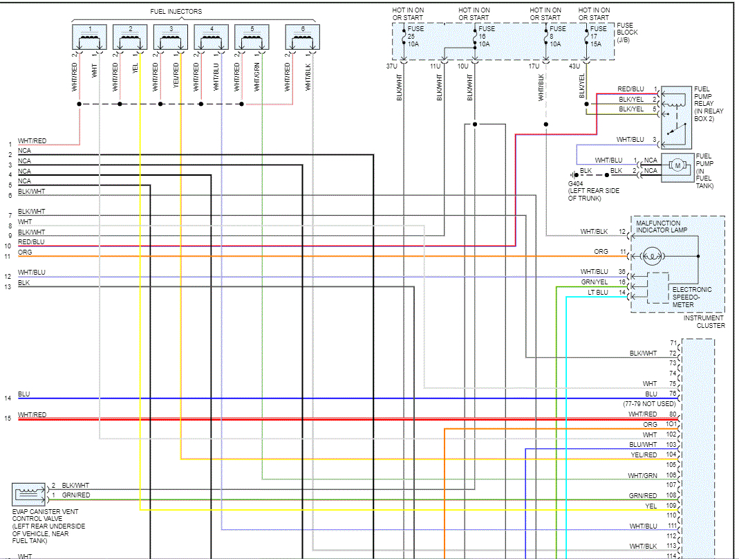

As far as the wiring schematics, I attached all of them for the power-train management. There were three pages of schematics. I cut them in half to make them readable, but I did overlap them to help you follow them easier. They include the distributor, IAT, and so on.
Let me know if this helps.
+1
Sunday, May 24th, 2020 AT 7:34 PM

Hello Joe.
Thanks for the diagrams.
Let put this sensors where they suppose to be.
I think I had a bad ECM or a bad TPS.
I'm going for the TPS first and I let you know.
I'm sending you a video and see the changes on the readings on the TPD vs the rpm's.
Thanks,
Juan Marin
Monday, May 25th, 2020 AT 7:00 PM
  • 110,194 POSTS
Juan,
I see the RPM's increase but the speed doesn't. Are you certain the transmission isn't slipping that bad?

what about the readings of the TPS? The voltage signal change as you see on the video.

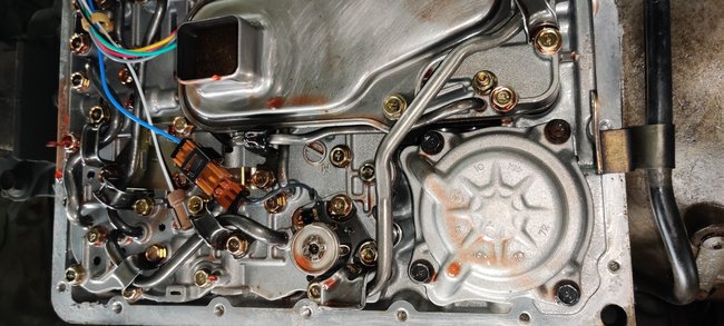

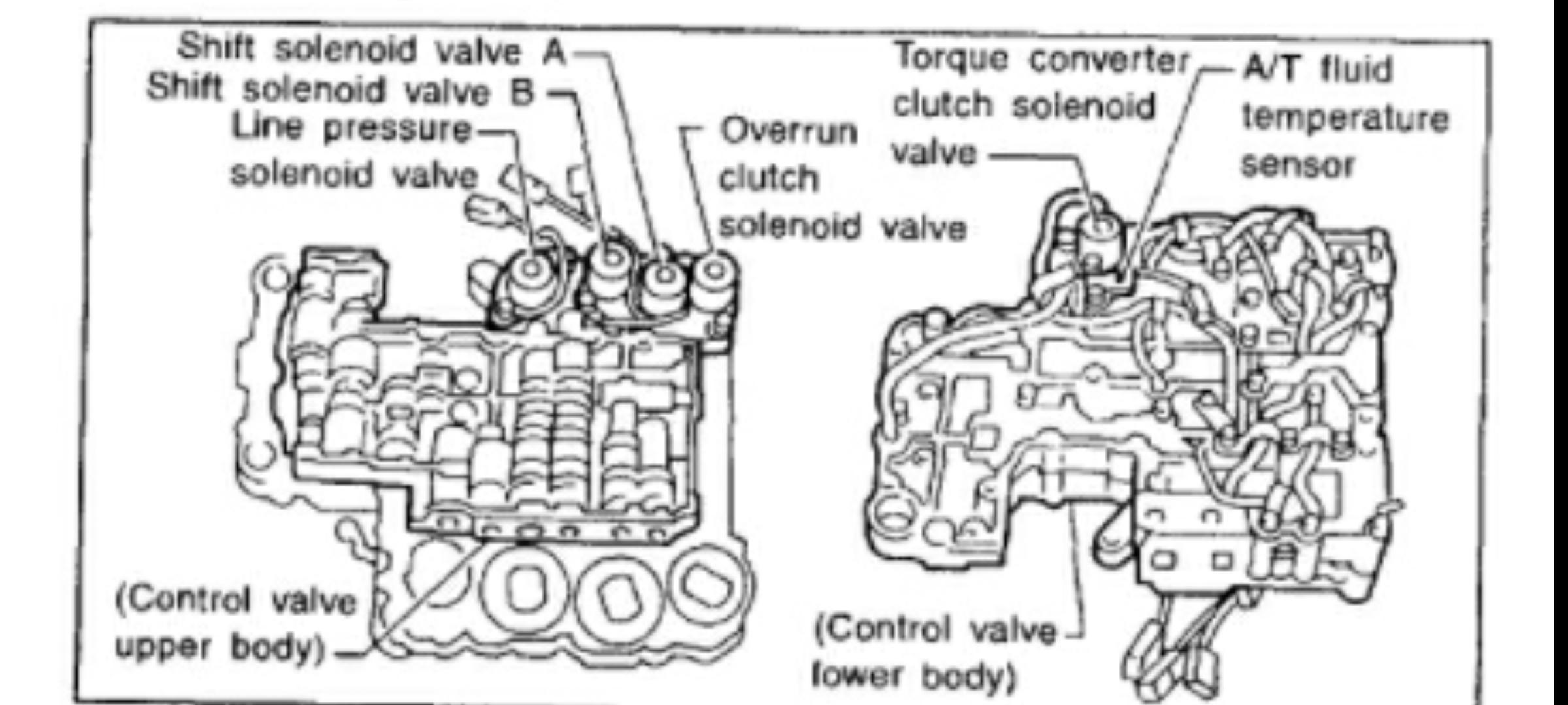

I'm going to drain the transmission fluid pan take it out and check for what you suggest to me. Maybe the shifting solenoids are clog. I can test them putting 12v directly and if they make a click there are okay or there's another way to test them?
The ones on the image, right?

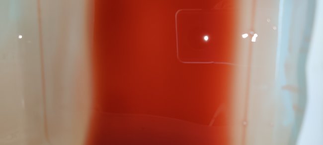

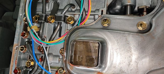

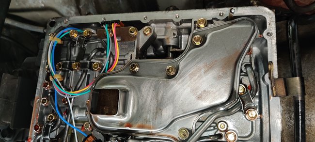

I didn't find any visible damage on the transmission, no excessive dirt, no metal shavings, the filter is in good condition, it's smell normal (no burnt smell), the color of the fluid is okay. I send you photos.
Let's continue discarding things. Shifting solenoids (overrun clutch, EPC, SSA shift and SSB shift), throttle position sensor, torque converter clutch solenoid, speed sensor.

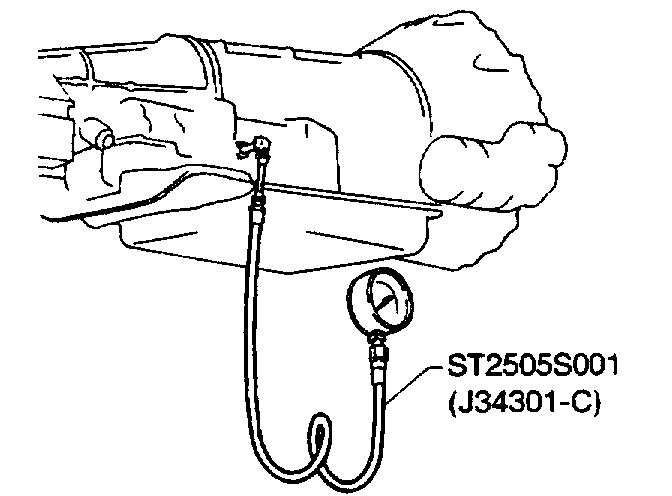

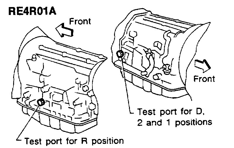

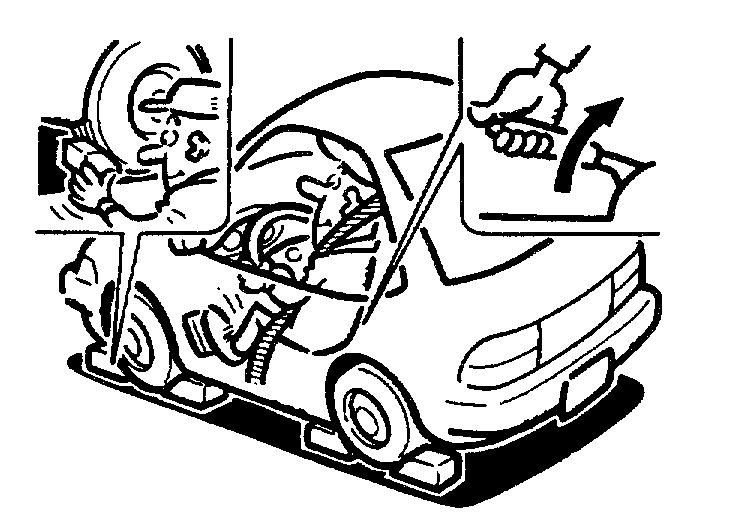

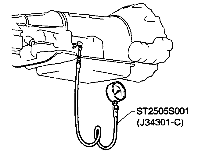

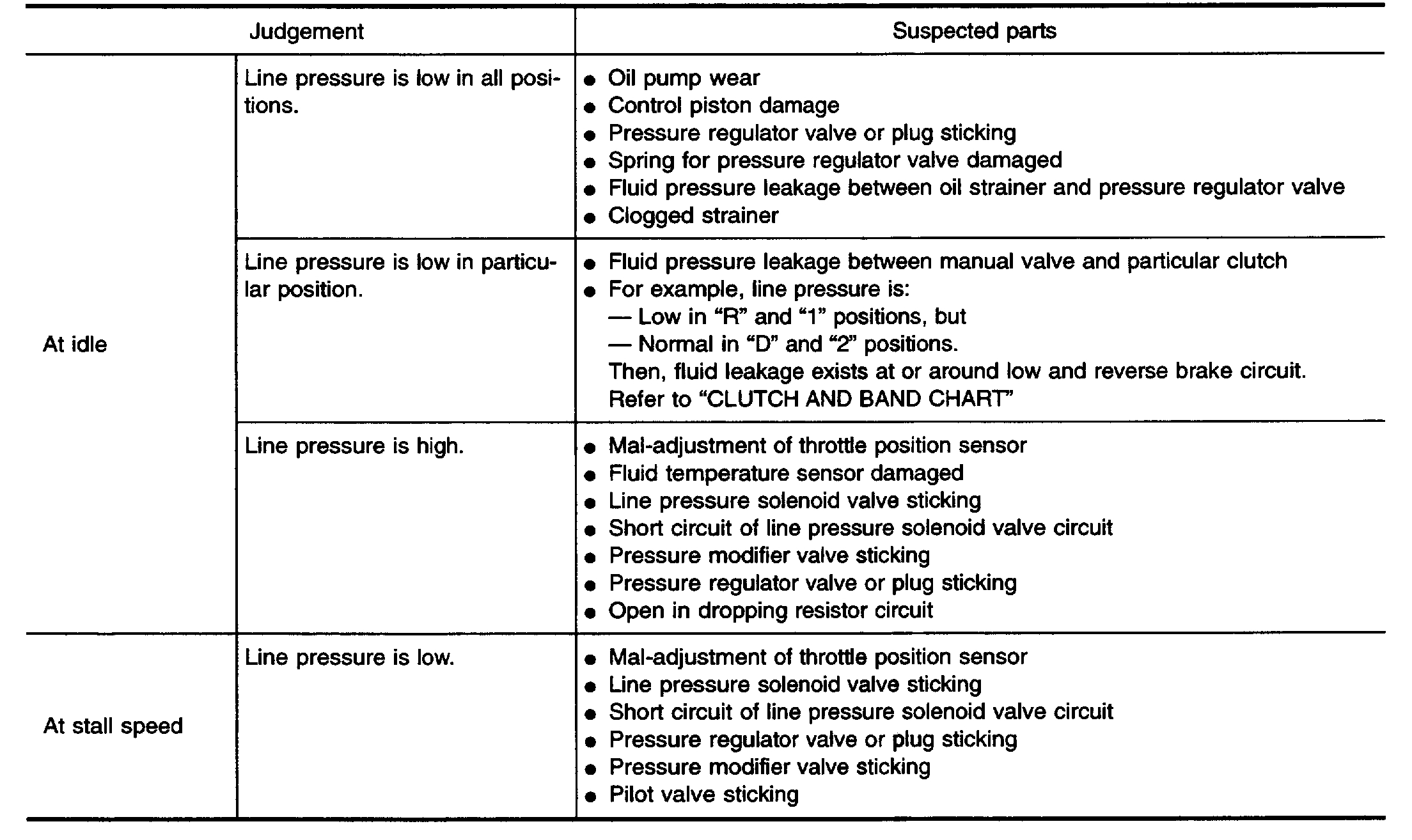

The next thing I would check is line pressure. Here are the directions for that procedure. The attached pics correlate with the directions.
______________________________________
1999 Nissan-Datsun Truck Pathfinder LE 2WD V6-3.3L (VG33E)
Line Pressure Test
Vehicle Transmission and Drivetrain Automatic Transmission/Transaxle Testing and Inspection Component Tests and General Diagnostics From VIN # 350001 Basic Inspections Line Pressure Test
LINE PRESSURE TEST
LINE PRESSURE TEST PORTS
pic 1
- Location of line pressure test ports.
- Always replace line pressure plugs as they are self-sealing bolts.
LINE PRESSURE TEST PROCEDURE

3. Install pressure gauge to corresponding line pressure port.
Pic 5

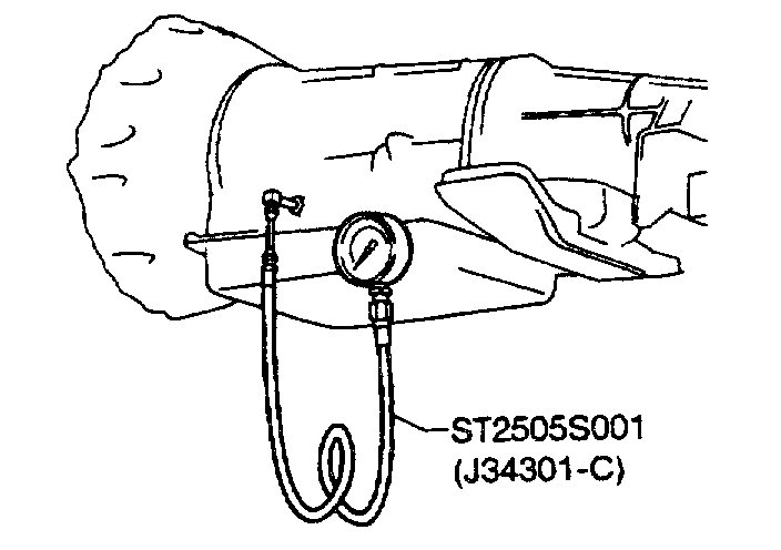

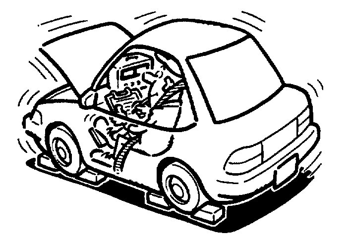

4. Set parking brake and block wheels.
- Continue to depress brake pedal fully while line pressure test is being performed at stall speed.
Pic 6
5. Start engine and measure line pressure at idle and stall speed.
- When measuring line pressure at stall speed, follow the stall test procedure.

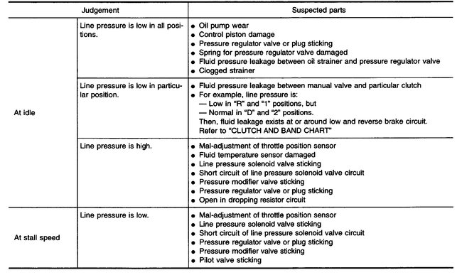

JUDGEMENT OF PRESSURE TEST
