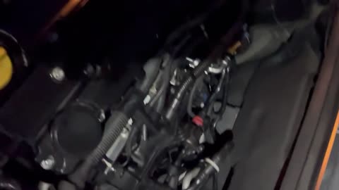

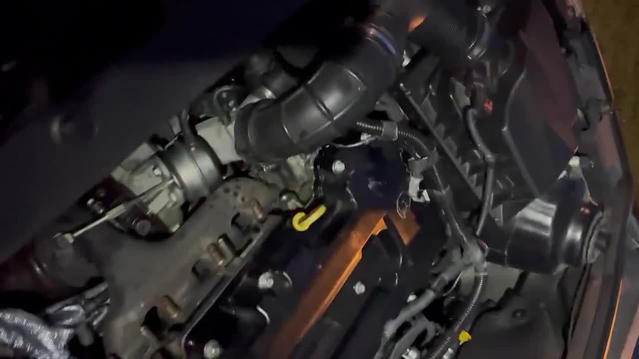

I just replaced my head gasket and when I started car I'm hearing a loud knocking that gets faster as I rev the engine.

Did this just start since the head gasket repair? Is the engine oil full and not contaminated with coolant?
Does the sound seem to be more at the top of the engine or the bottom? Can you record it and upload it for me to hear?
Let me know. In the interim, take a look through this link and let me know if anything mirrors what you are experiencing:
https://www.2carpros.com/articles/engine-noises

Yes, just started after head gasket replace, it gets faster with rise in RPMs. Could it be the timing? It sounds like it’s toward the back of engine where intake is located.

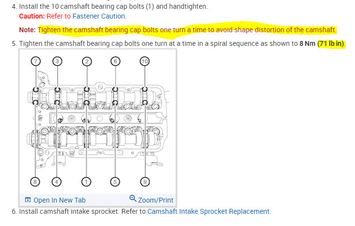

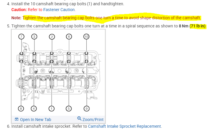

When you tightened the camshaft bearing caps, how was it done? Believe it or not, they are all to be tightened hand tight and then in a specific sequence tightened one turn at a time until 71 Inch Pounds is reached. Is that what was done? Did you possibly overtighten them? People oftentimes don't realize there is a big difference between inch and foot pounds and over-tighten them.
See pic below.
