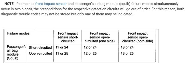

No, it's in the transition period of ob1 and ob2 so I grounded pin #1 and with MAF plugged in I get: 1 long flash followed by a 2 quick flashes =12 then a 2 long flashes followed by a 5 quick flashes. So a 12 and 25.

Definitely a 12 and a 25.

Hi Camc61,
The 12 is wheel speed sensor open or shorted wire and the 25 is related to the airbag system for both together see the image I uploaded.
Tom
