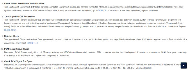

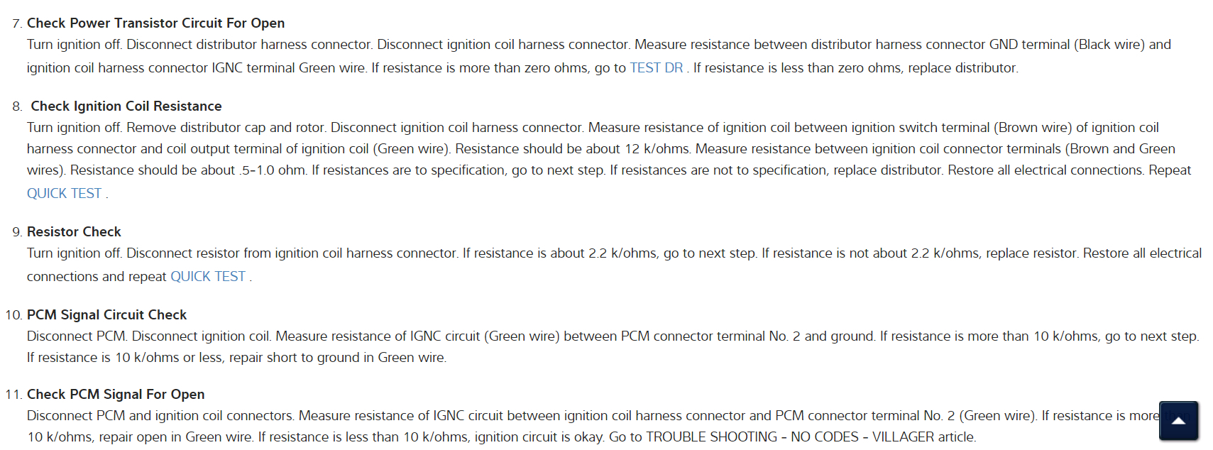

Hello, I have the van listed above. Yesterday afternoon, I started the van to go to the store and I notice that the check engine light stayed on. When I got back home and got the groceries put up I went back out side with my obd 2 code reader. I had a code reading of “p1320”. I looked the code up on the internet and it said that the code reading means either “primary ignition signal or ignition coil or wire to the ignition coil or distributor”. Can you tell me step by step how to check this out? The van runs good, but does have a miss while sitting at a stop light or stop sign. Thank you, Bill Hewitt

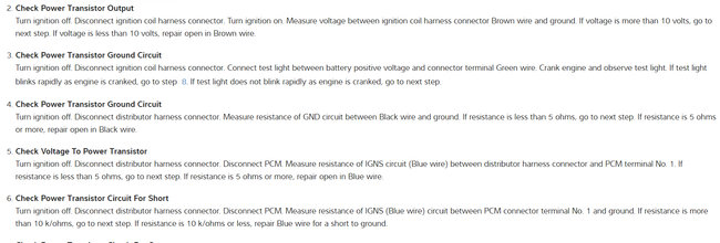

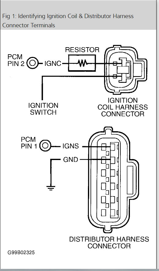

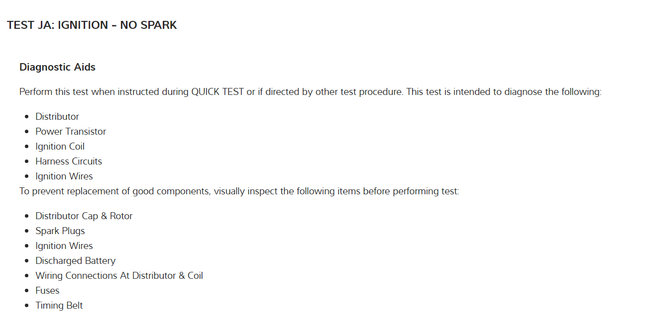

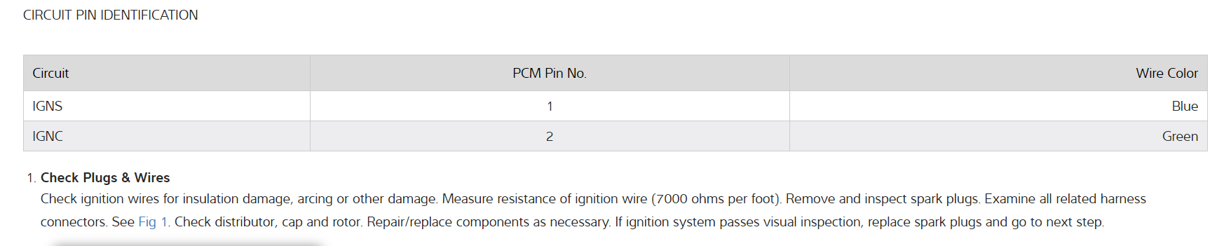

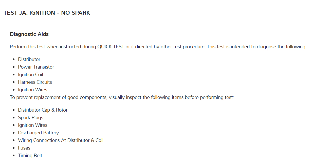

Direct Trouble Code(DTC) 1320 is a manufacturer specific trouble code meaning Distributor Signal Interrupt. I have included a step by step troubleshooting guide for you in the diagrams below. Run through it and let us know what you find out.
