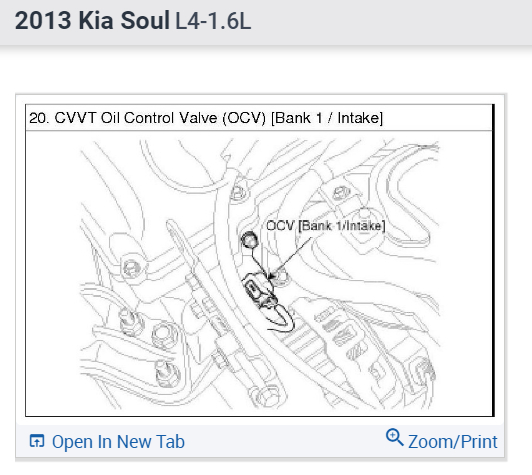

I had an obd reader and it came up with camshaft and crankshaft sensor correlation? I have changed the Camshaft position sensors. Crankshaft Position Sensor. PCV Valve and VVT Solenoids. But still the check light comes on after about five miles of driving.

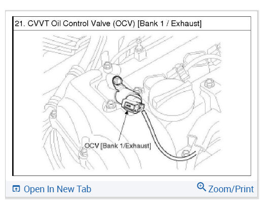

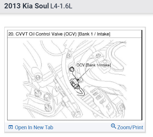

This happens when the oil pressure is low, or the cam phasers are worn out. Can you give me the codes number so I can tell you how to fix it? I would make sure the engine oil is clean and full. Just to be sure these are the valve you changed out. Check out the images (below). Let us know what happens and please upload pictures or videos of the problem so we can see what's going on.

I have got a mobile mechanic coming here Thursday to change the timing chain. Tensioners and sprockets apparently that's the problem.

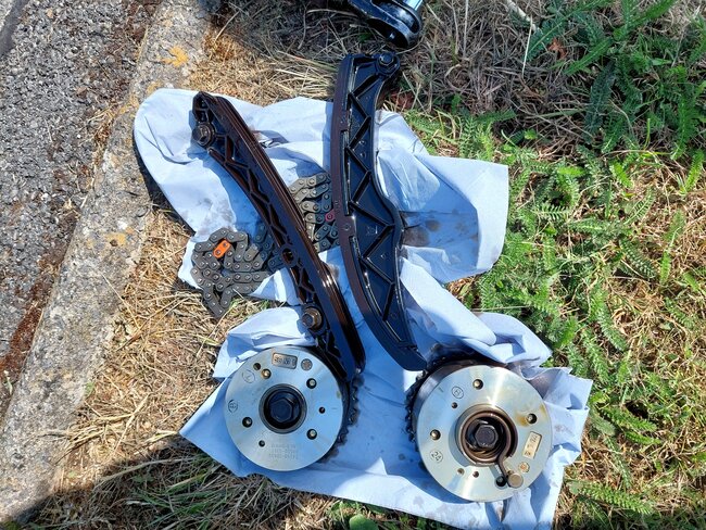

Okay, will get some photos of the old timing chain tensioners and sprockets before he changes them.

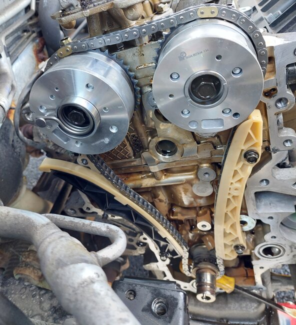

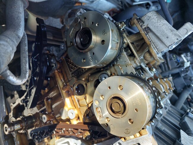

Old and New.
Thursday, June 29th, 2023 AT 7:10 AM
KEN L
  • MASTER CERTIFIED MECHANIC
  • 55,266 POSTS
Nice work, it looks like the engine has been well taken care of. The new actuators should fix the problem, make sure to change the oil and filter, clear the codes when the repair is completed. Let me know what happens please.

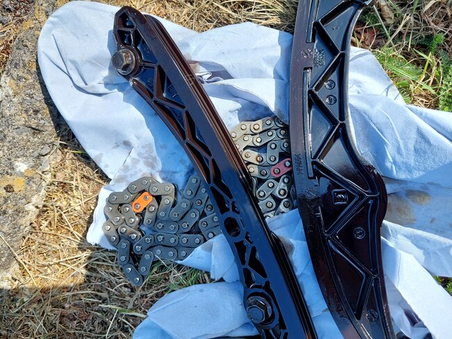

There were a few worn teeth on the sprockets which would cause the engine check light to come on. The mechanic said the cam lobes/lifters were like new and didn't look like they had covered 80,000 miles.

Problem solved the engine seems to have more torque and now flies uphill. It now goes like a twin cam now.
