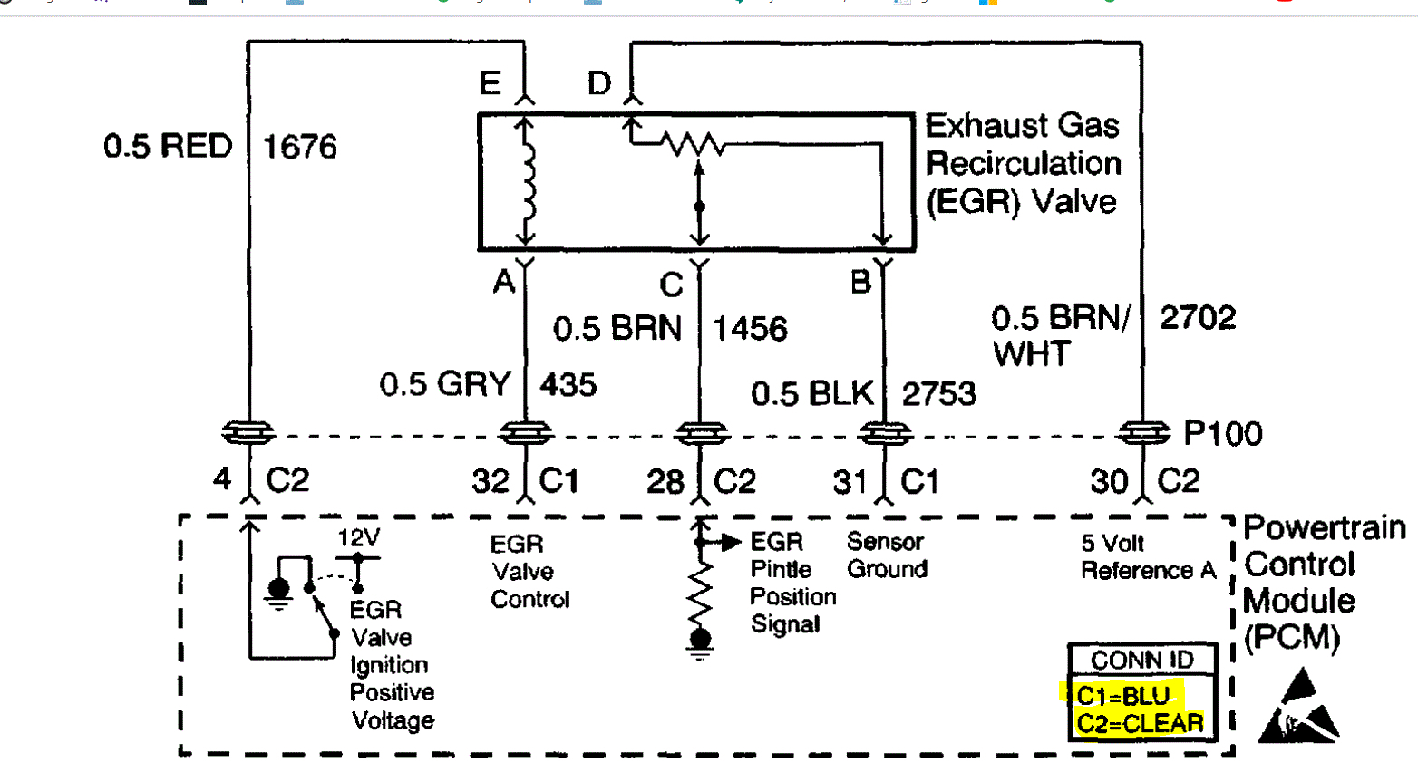

The codes are both related to the EGR and deal with an electrical issue (low voltage). Do you have access to a live data scan tool? It is needed if I provide the diagnostics related to the codes. If not, the best we can do is check the connections at the PCM.

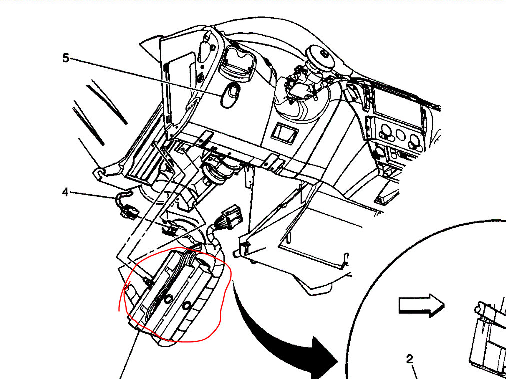

I attached a schematic below and highlighted the connector colors. The PCM is located below the left side of the instrument panel near the steering column.
Make sure the battery is disconnected prior to disconnecting the PCM connections, and reconnect the PCM before you reconnect the battery.
Pic 2 shows the PCM and how it's oriented under the dash.
Let me know what you find.
