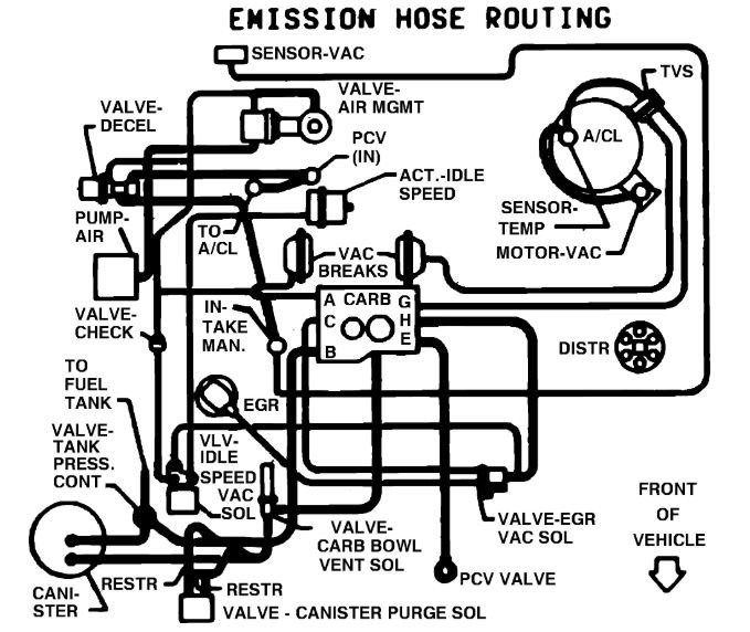

So I had never worked on a car in my life and I got this for free (first car as well). I replaced the rocker arm gaskets and messed up the emission hoses in the process and now it has no power like before and I can't figure out the diagram. Any help would be appreciated.
Wednesday, April 22nd, 2020 AT 8:56 PM
15 Replies
Good morning,
Can you upload a video of the top of the engine so I can see what you see?
I need to see how you have the hoses hooked up so I can help.
I attached a vacuum hose diagram for you to view.

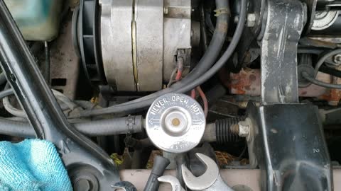

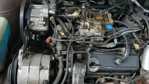

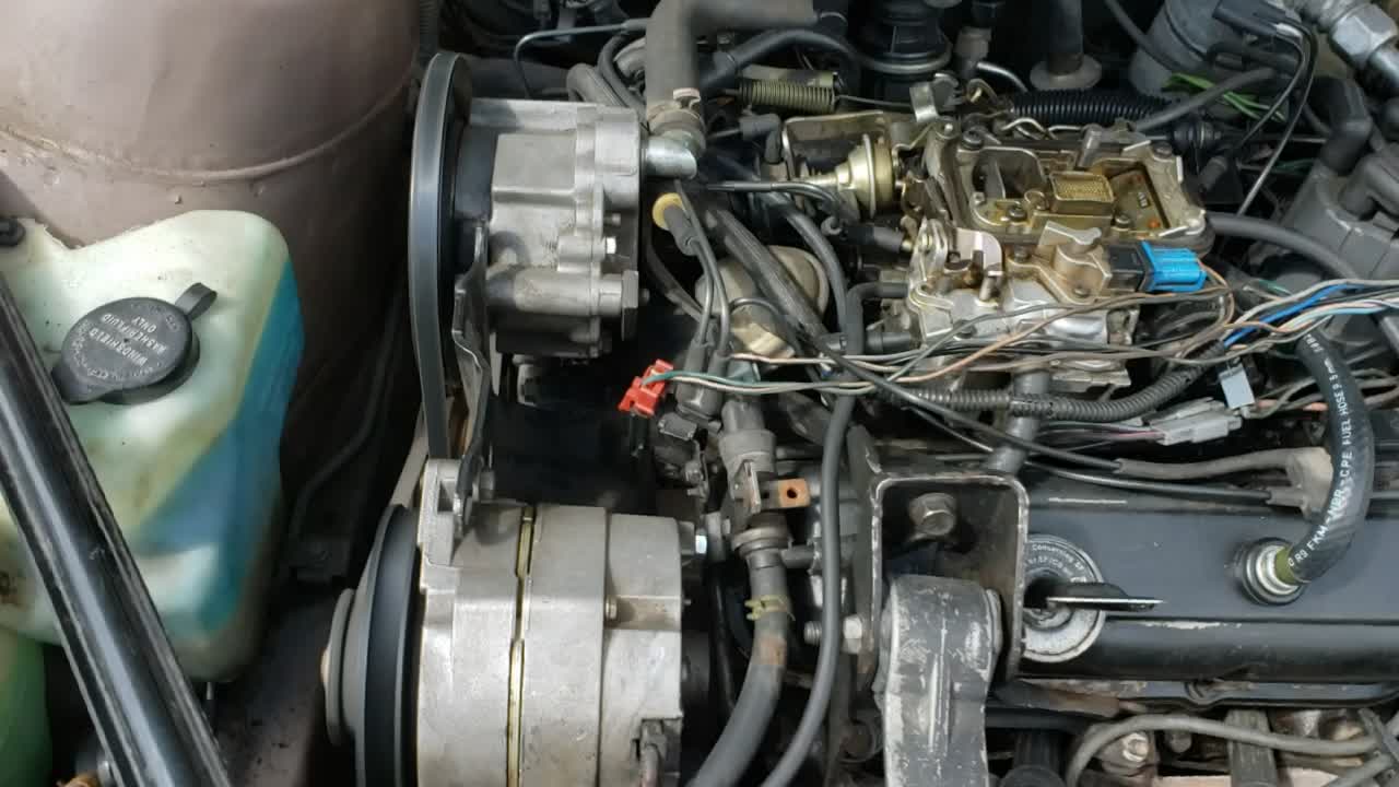

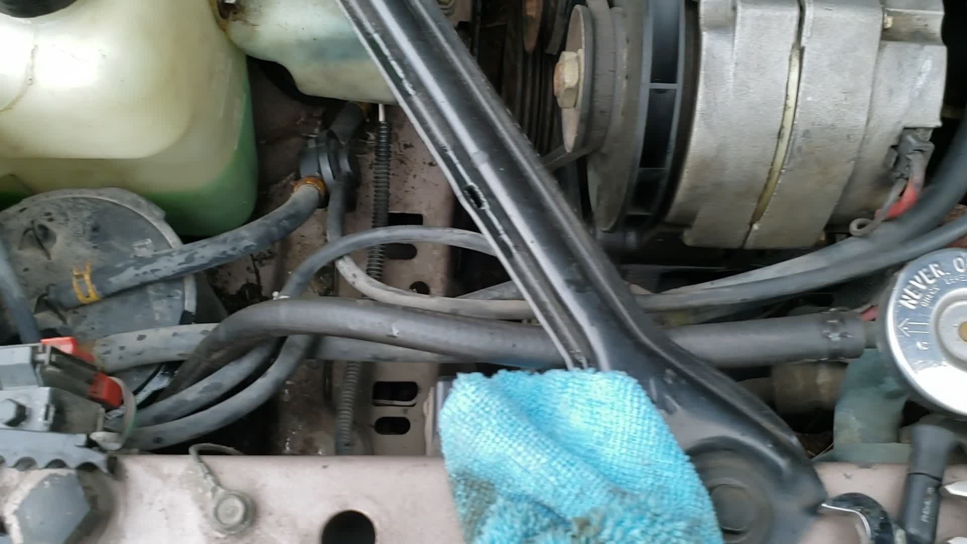

Yea here you go. Just let me know if you need to see anything specific.
Thursday, April 23rd, 2020 AT 11:52 AM
Okay, that did not help that much.
Disconnect the EGR valve and drive it and see if it has power now.
