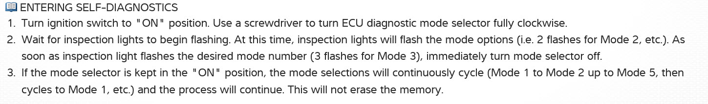

When to check the trouble codes something shorted out and now this ECM lights do not come on and not getting fire.
Monday, July 4th, 2016 AT 9:51 AM
5 Replies
HMAC300
  • 48,601 POSTS

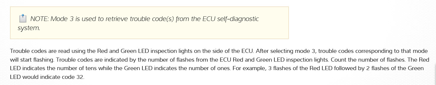

Check fuses and main relay under hood first then scan for codes. See picture to see how to do it to set to correct mode then get them out. Then you can either get back to us or go to repair guides on our site here and look for trouble codes then OBD1.
