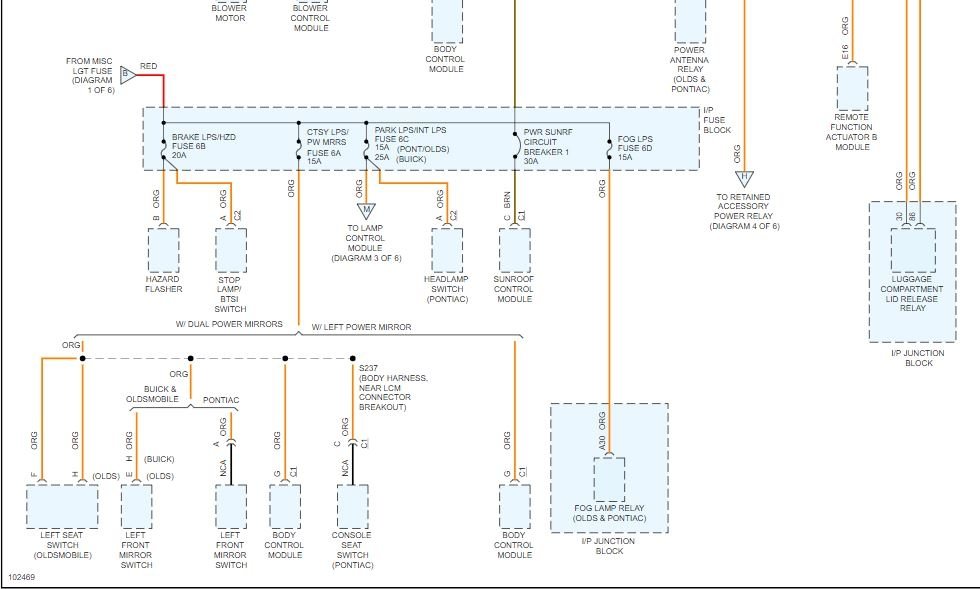

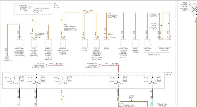

Good morning,

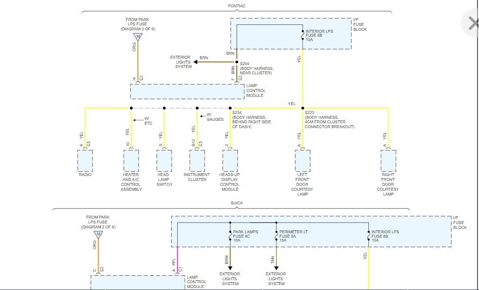

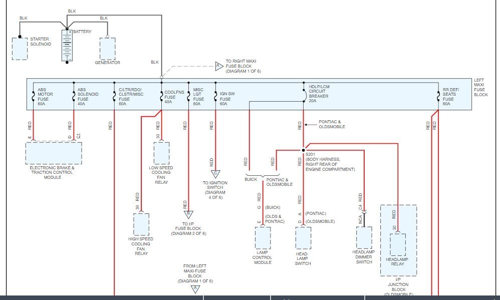

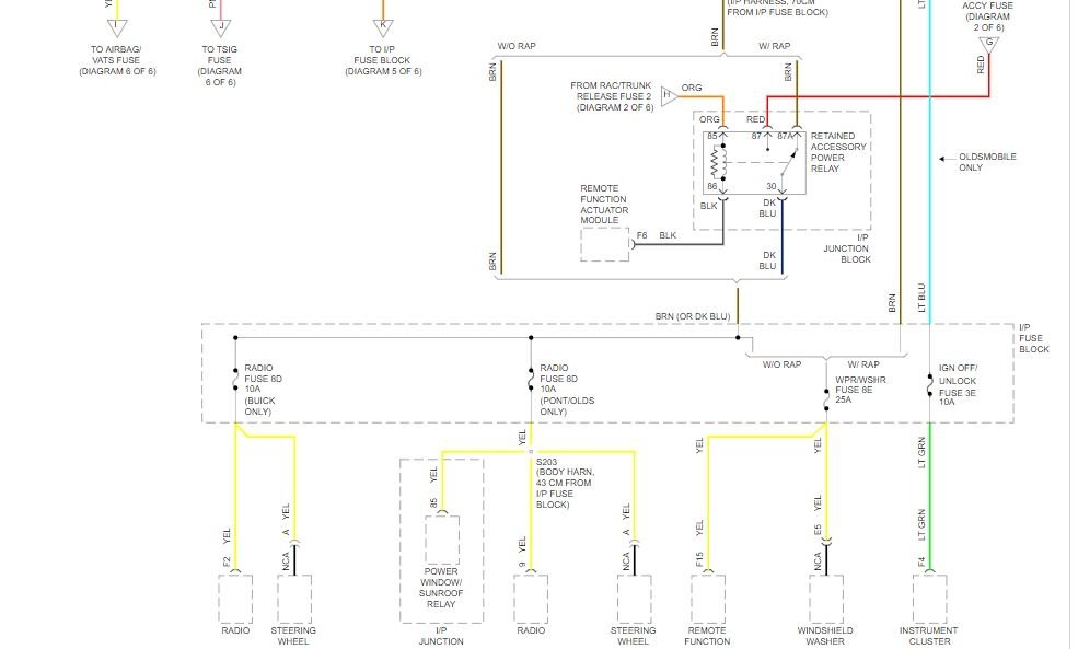

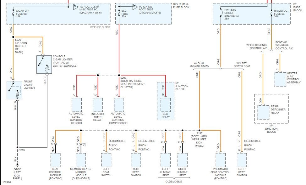

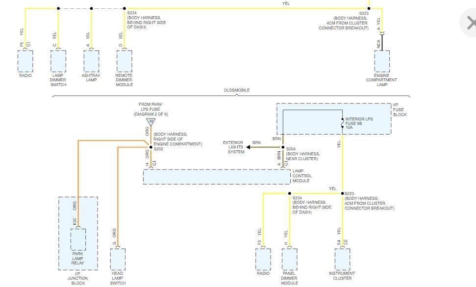

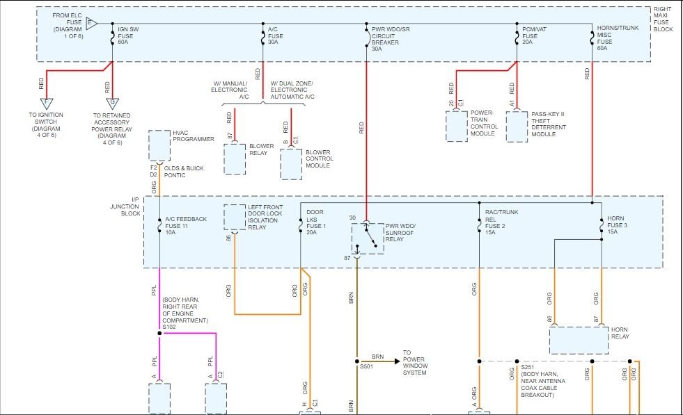

I attached the wiring for the fuse boxes.
Can you confirm there is power to any of the fuse boxes?
