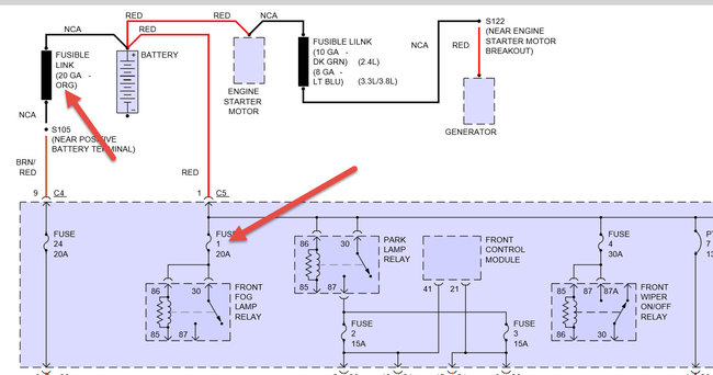

I changed radiator in it and now I am not getting power to anything but the battery power point.

Check fusible link in picture and all fuses in PDC under hood.
Image (Click to make bigger)
