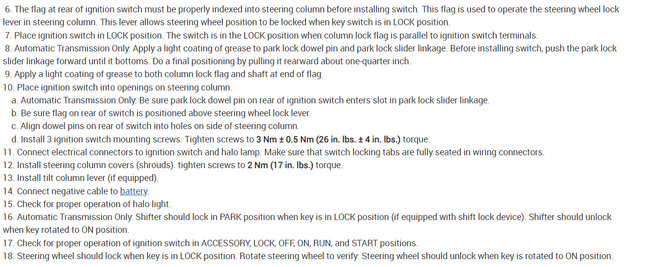

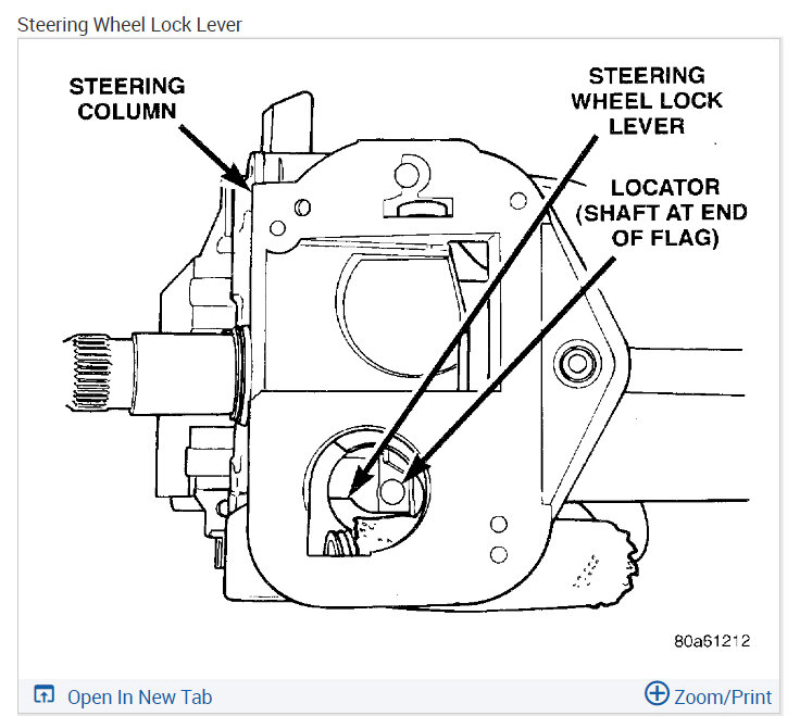

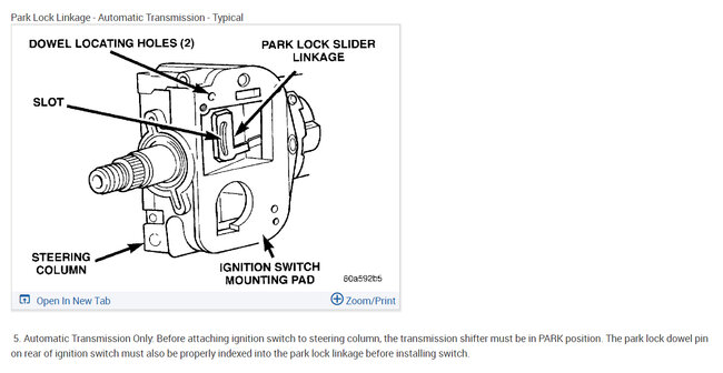

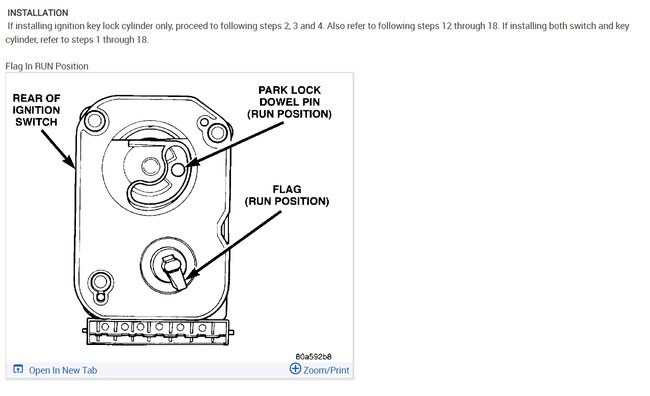

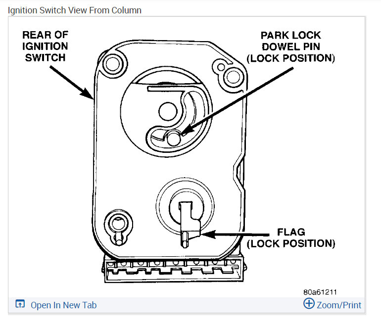

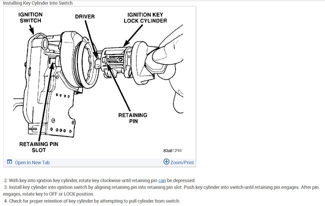

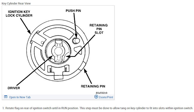

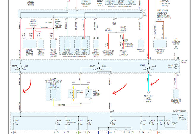

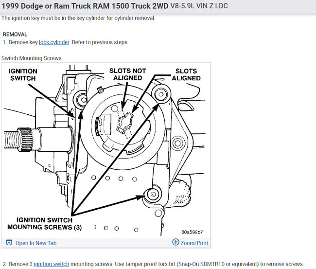

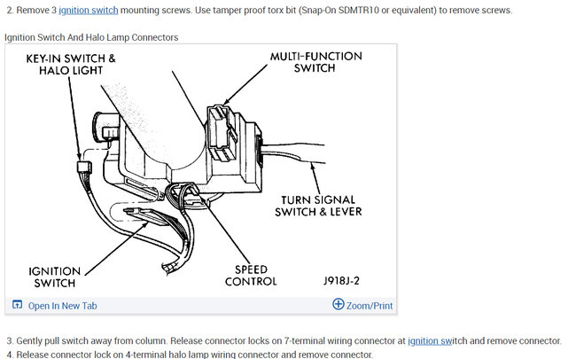

It sounds like you may have two problems the following test can help confirm the issue. Lets test for the power output through the ignition switch.
Here is the location of the switch and a guide to help you with the testing:
Do your testing with the key on. Check out the images (below). Let us know how it goes.
