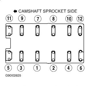

i need to see if anybody had the order for the brackets that hold down the camshaft?

All bearing caps are numbered except #1. I for intake E for exhaust
