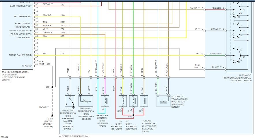

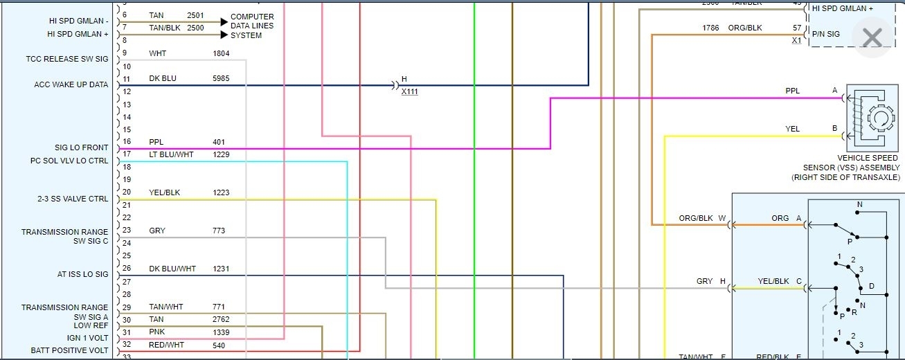

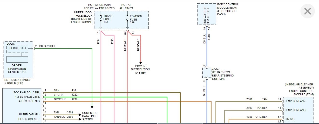

Transmission output sensor wires are damaged and would appreciate a diagram to properly repair.
Friday, August 16th, 2019 AT 9:50 PM
MECHANIC
110,192 POSTS
Welcome to 2CarPros.
I attached the entire schematic for the transmission. I had to break it into 3 pictures to make it readable but I did overlap so you can follow it.
Let me know if this helps.
