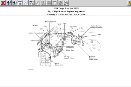

WHERE IS THE PCM LOCATED AND CAN I USE ONE FROM A OTHER VAN SAME YEAR AND MOTOR

if it is the same van and engine, then yes you can use the pcm from the other, but I need to know make model ,year, in order to give the exact location

if your van is one of the B series vans 1500,2500,3500, then they are all in the same place, that is in the center of the firewall, I have a diagram.

PCM
https://images.2carpros.com/forum/automotive_pictures/88091_dodge_van_1.jpg
