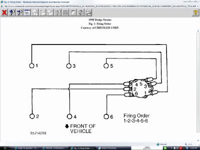

98 dodge stratus 2.5 V6, 101k: I recently did a tuneup on my car, replaced the plugs, wires, cap and rotor. I did not use OE plugs or wires, I used Bosch platinum. Now when it is cold the car runs okay, once it gets warmed up it struggles to accelerate, almost stalling but never does. If I can get past 10 mph it seems to run fine. Check engine light is on and is putting out codes for the TPS and misfiring on cylinders 4,5 and 6. Should I try OE plugs (champion) and replace the TPS? or could it be something else? Any input would be appreciated.

I would check that you didn't cross a few plug wires, Here is the firing order, re check it!
https://images.2carpros.com/forum/automotive_pictures/62217_Startus_FO_1.jpg

I rechecked all wires and pulled everything apart again, then reinstalled just to make sure I didn't do anything wrong the first time. I am noticing that this only happens when the car is in drive or reverse while accelerating plus minor hesitations while at idle in either drive or reverse. If the car is in park or neutral there are no signs of any hesitation at all even when I give it gas??? I'm thinking that it seems very possible that it is the TPS but am trying to diagnose further so I don't waste $ on parts I don't need; any help would be appreciated.
