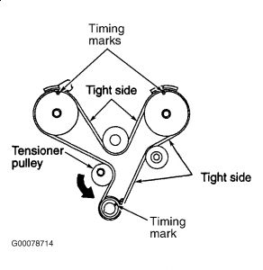

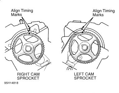

Hello, I removed the timming belt and put a new one, the motor start failing to much, my question is: how many positions have the crancshaft sproket? Thanks

Engine timing belt must be set as per 2 pics.
