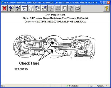

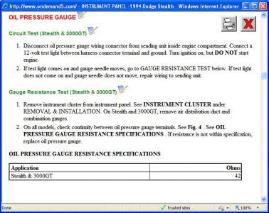

Changed oil sending unit and switch and there is no reading on the gauge. It is a new long block engine. Any ideas
Friday, August 20th, 2010 AT 11:52 AM
SATURNTECH9
MECHANIC
30,869 POSTS
Try what i posted and see what you find.
