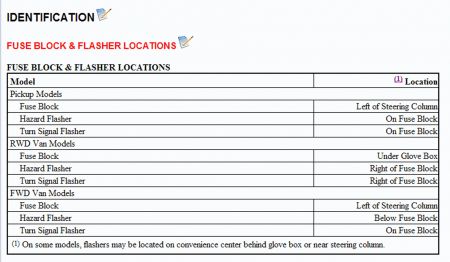

Where is the fuse box located on a 84' Dodge Ram Prospector?

On the left side of the steering column, on firewall.
