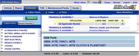

I was informed that the total labor hours to R&R the automatic transmission is 28 hours. Could you please tell me what the REAL total labor is for such a job. At this shops rate, the labor alone will be almost 3000. Thank you for your help

See below
http://www.2carpros.com/forum/automotive_pictures/12900_tranny_3.jpg

Hi there,
The labour time to R & R this transmission is 4 to 5 Hrs max.

Its 12 to 14 hours For R/R and rebuilt
28h is very steep
