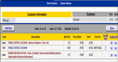

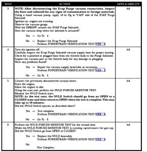

Well, based off of the code it is the proportional purge solenoid. Now you are supposed to do some checks of the system with a scanner to make sure that is the problem. I just kind of followed the troubleshooting tree to see where it would take me.
I have attached a few things for you.
The item location, a couple of pics of that.
What it is and what it does.
The actual troubleshooting chart information
The removal and installation if you or someone can do that.
An estimate of a shop doing it. The shop estimate is again, an estimate. Could be a little more or less but that is ball park.
Also remember, without test equipment I am only giving you a best guess. . ...but this should get you in the area.

SYMPTOM
P0441-EVAP PURGE SYSTEM PERFORMANCE
WHEN MONITORED
Cold start test. Engine Running. Small leak test passed..
SET CONDITION
The PCM activates the EVAP Purge solenoid gradually increases to maximum flow. During flow, the PCM looks for the NVLD switch to close. If the PCM does not see the NVLD switch close at maximom flow an errow is detected. Two Trip Fault.
POSSIBLE CAUSES
Good Trip Equal to Zero
NVLD Switch Operation
Vehicle History and Service Bulletin Investigation
Checking EVAP Purge Solenoid Functionality
EVAP Purge Vacuum Supply
Verify NVLD Operation

Oh, one other thing....... Looks like you may have some recalls on your vehicle. The dealer may fix these for free. Please contact the dealer service department, give them the VIN number of your car and have them check on these to see if they apply to you.
