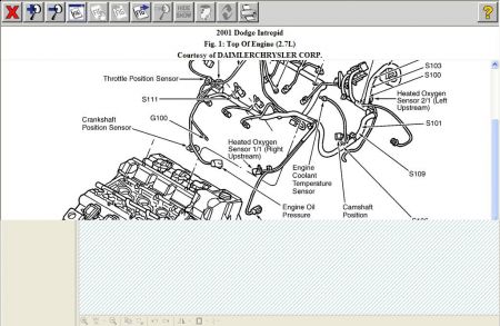

Need to know location of oil sensor. The light keeps flashing

2.7L right side block 3.3/3.5L left side block

Oil pressure switch
2.7L see below
3.2 and 3.5L on left side of engine-sorry no pic for exact location
