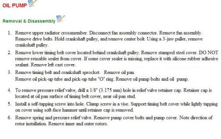

How to change the oil pump
Tuesday, August 25th, 2009 AT 11:51 AM
