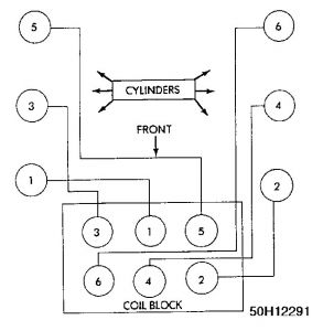

Where is the bank 1 oxygen sensor
Thursday, January 28th, 2010 AT 1:30 PM
MECHANIC
110,192 POSTS
It is on the same side of the engine as cylenders 1, 3, 5. Here is a picture:
Let me know if this helps.
