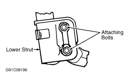

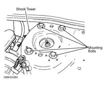

When i turn me wheels, when moving or parked, there is a loud clunk/thunking sound coming from the drivers side wheel. From what i have read most people say this is a CV joint problem, but looking at my CV joint the boot is still in great condition. I am wondering if this could be the strut bearing gone bad. If so: Is there any down side to just replacing just the one bad side with a "quick strut" complete assembly? If I do put on a quick strut do i need to worry about alignment problems, since i wont be turning the tie rod at all?

You can replace just one strut as for the alignment replacing the strut will change the alignment
https://images.2carpros.com/forum/automotive_pictures/99387_int_1.jpg
https://images.2carpros.com/forum/automotive_pictures/99387_intr_1.jpg
check inner tie rod end bushings
