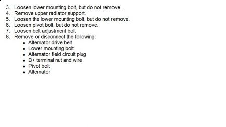

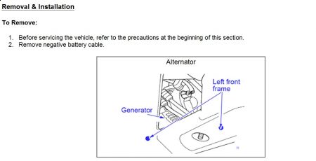

How to replace alt.

I found this information,
