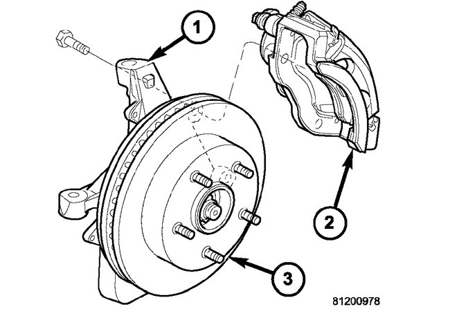

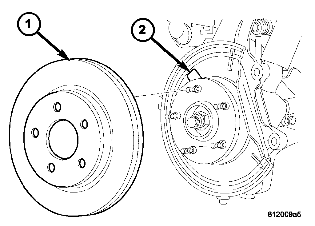

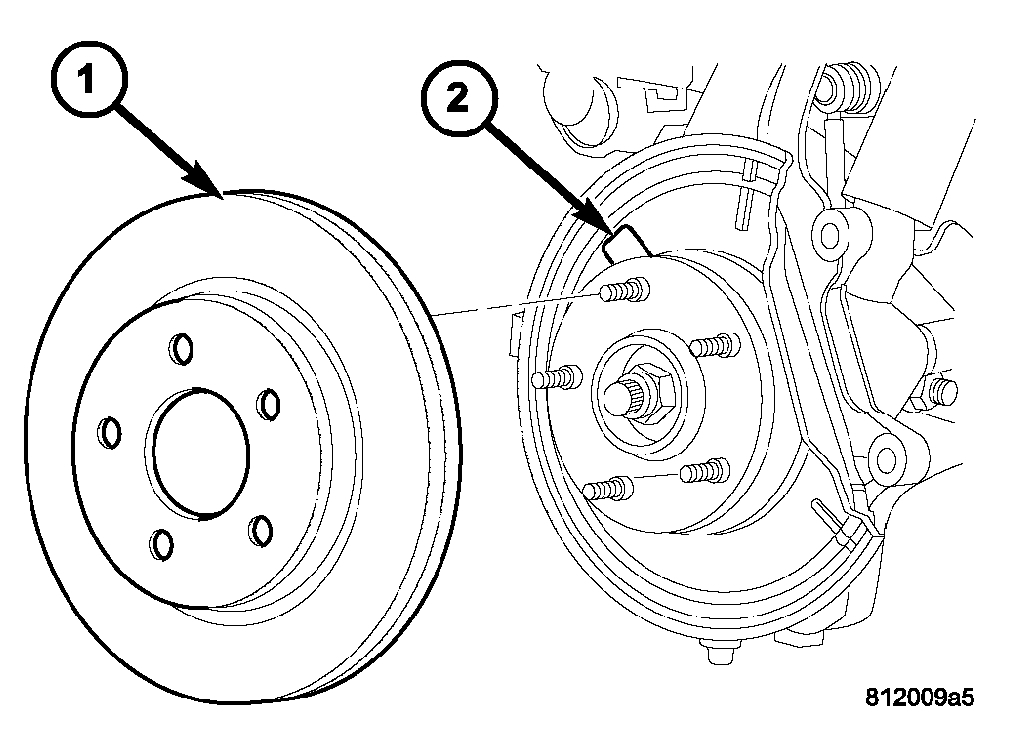

What you described sounds like warped brake rotors. If they were not replaced when the pads were, that is what I would recommend doing. Here are the directions for replacement of the rotors. The attached pictures correlate with the directions.
______________________________
2004 Dodge or Ram Truck Durango 4WD V8-4.7L VIN N
Front Brake Rotor
Vehicle Brakes and Traction Control Disc Brake System Brake Rotor/Disc Service and Repair Procedures Brake Rotor - Removal and Installation Front Brake Rotor
FRONT BRAKE ROTOR
REMOVAL
pic 1
1. Raise and support the vehicle.
2. Remove the wheel and tire assembly

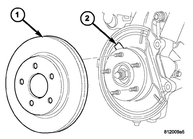

pic 2
3. Remove the caliper (2) from the steering knuckle (1), and remove caliper adapter assembly.
Note: Do not allow brake hose to support caliper adapter assembly.

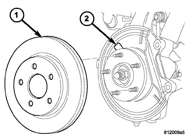

pic 3
4. Remove the rotor (1) from the hub/bearing wheel studs (2).
INSTALLATION

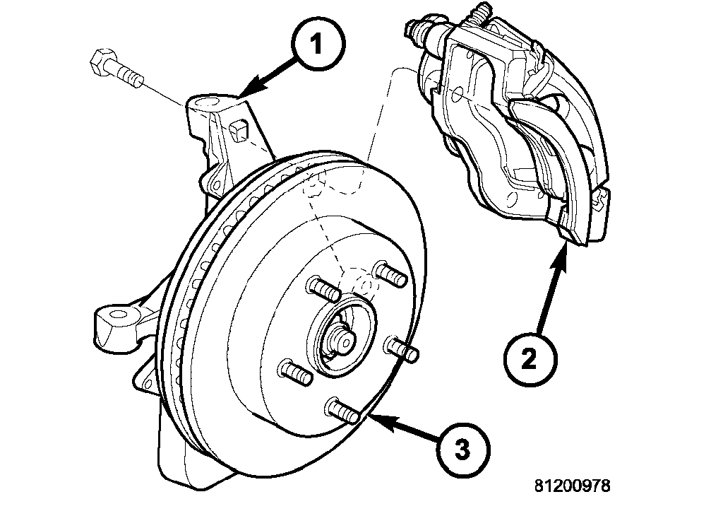

pic 4
1. On models with all-wheel antilock system (ABS), check condition of tone wheel on hub/bearing. If teeth on wheel are damaged, hub/bearing assembly will have to be replaced (tone wheel is not serviced separately).
2. Install the rotor (1) onto the hub/bearing wheel studs (2).

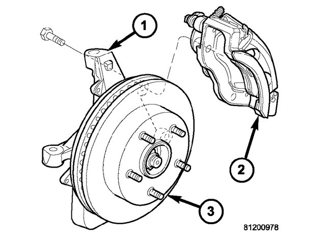

pic 5
3. Install the caliper adapter assembly (2), and tighten adapter bolts to 176 Nm (B0 ft. lbs.).
4. Install the wheel and tire assembly and lower the vehicle.
5. Apply the brakes several times to seat brake pads. Be sure to obtain firm pedal before moving vehicle.
