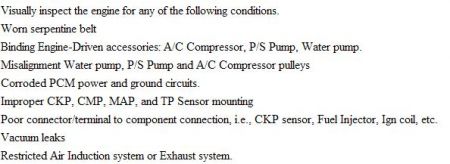

I got a reading on a dianostic hand held that said
cylinder 6 misfire detected
P0306 MOD$00

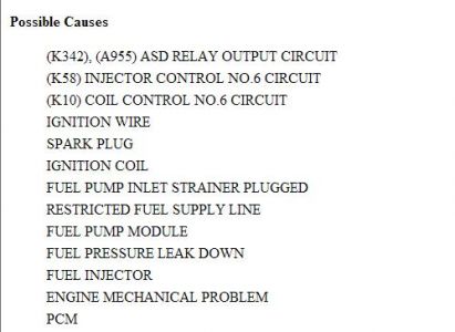

List of possible causes for this code to appear are below along with a few inspections to make..
Post results and I will follow up..
