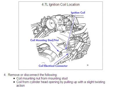

How do I nchange plugs in a 4.7

With coil on plug ignition, remove the coil first. Then you will probably need a rachet--extension--spark plug socket. I believe the spark plug hex is 5/8, don't quote me on that?
