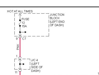

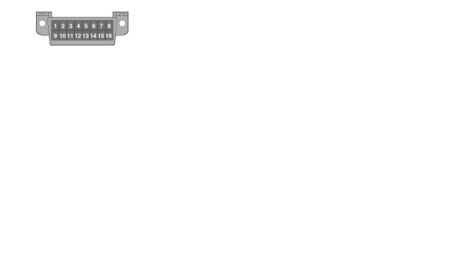

My scanner is unable to scan the computer on the truck could the pcm be bad
Sunday, October 10th, 2010 AT 12:34 PM
JDL
MECHANIC
16,098 POSTS
Does pin 16 at the datalink connector have voltage?Not the best picture is it? Pin 16 gets voltage from the fuse in the diagram.
