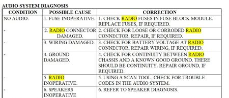

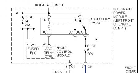

Hi, I have a problem with radio in my car. What happens is when you turn on the radio you can hear the sound and in like 5-10 seconds it goes off. It repeats every time you turn the radio on. It is factory radio never had been removed, what can I do to fix it?
I'm sorry, I should've mentioned that when sound goes off, radio/cd player still working(lights are on and it shows what track its on and so on).

I'd check fuses first. Not only check the fuse, check for voltage on the fuse circuit. One of those fuses doesn't go hot unless relay is energized.
https://www.2carpros.com/forum/automotive_pictures/170934_caravan_base_radio_1.jpg
https://www.2carpros.com/forum/automotive_pictures/170934_caravan_audio_system_1.jpg
