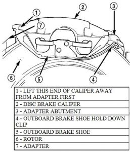

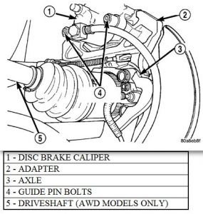

1) what bolt secures the calipers? It is hidden under a boot and looks like it must be an allen screw? Or something?
***2 Allen guide pin under the black rubber.
https://www.2carpros.com/forum/automotive_pictures/55316_05caravanrearcaliper_1.jpg
https://www.2carpros.com/forum/automotive_pictures/55316_05caravanrearcaliper2_1.jpg

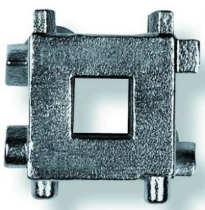

3) What tool is required to reset the calipers before re-assembly?
Powerbuilt 648410 or equivalent
https://www.2carpros.com/forum/automotive_pictures/55316_648410_7.jpg

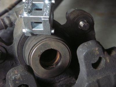

Zackman, thanks! Your pictures are very appreciated. However...
Now the caliper is off, the dead pads are removed, and there does not seem to be any way shape or form that the caliper compression tool interfaces with the caliper :-/
I've included a photo that shows the caliper tool and the smooth, round, featureless caliper face. I expected the caliper face to have holes of some kind to match the protrusions of the tool...
https://www.2carpros.com/forum/automotive_pictures/357456_IMGP6386_1.jpg
Is there a secret to using the caliper tool? Or should I just put a c-clamp on the caliper and squeeze it straight back?

ZACKMAN
  • 4,202 POSTS
You have the new style rear caliper with external parking brake shoes. Just use a C-clamp and push the piston back in. Return the little tool back to the store.
