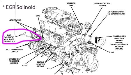

This is the second time on a long trip that this van had the P0406 code when the van stopped after 8 hours of travel. The Check engine light went out the next day, and never came back on during the return trip. Any idea what might be causing this?

Symptom: P0406 - EGR POSITION SENSOR HIGH When Monitored and Set Condition: P0406 - EGR POSITION SENSOR HIGH When Monitored: With the ignition on. Battery voltage greater than 10 volts. Set Condition: EGR position sensor signal is greater than 4.89. One trip Fault. POSSIBLE CAUSES Ã Â Â EGR POSITION SENSOR SIGNAL CIRCUIT OPEN Ã Â Â EGR POSITION SENSOR SWEEP Ã Â Â INTERMITTENT CONDITION Ã Â Â EGR POSITION SENSOR SIGNAL CIRCUIT SHORTED TO 5 VOLT SUPPLY CIRCUIT Ã Â Â EGR POSITION SENSOR SIGNAL CIRCUIT SHORTED TO BATTERY VOLTAGE Ã Â Â EGR SOLENOID ASSEMBLY INTERNAL FAILURE Ã Â Â SENSOR GROUND CIRCUIT OPEN Ã Â Â PCM
https://www.2carpros.com/forum/automotive_pictures/62217_caravan33_copy_1.jpg

Ended up changing the EGR valve, along with the belt since I had to loosen the alternator to get that lower bolt out. It was still in decent shape, but figured it was probably a good time to do that too.
Thanks again for the help.
