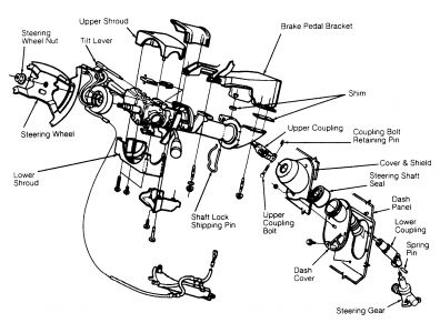

I went out to my van yesturday and it wouldnt start no noise no nothing. I also noticed that the steering wheel wouldnt lock. I replaced the starter and the ignition switch. It started a couple of times after replacing the ignition switch but then the same problem returned and the steering wheel still wont lock. Any suggestions?
Tuesday, December 9th, 2008 AT 7:37 PM
19 Replies
ZACKMAN
  • 4,202 POSTS
The two problems may or may not be related. The problem with the steering wheel is probably from faulty or broken steering column locking pin or from the steering column assembly itself.
The not starting may have something to do with the key switch assembly as improperly installed into the steering column as the locking pin being faulty. Or it could be from lack of electrical current from the battery, or broken fuse/relay.
I would check the steering column assembly locking pin first.

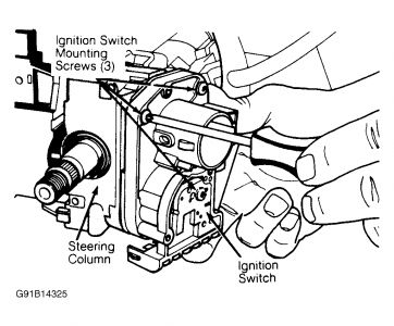

BMRFIXIT
  • 19,053 POSTS

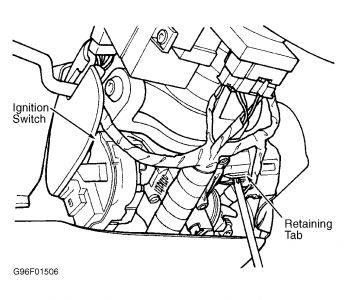

Ignition Switch (Removal & Installation)
Disconnect and isolate negative battery cable.
On tilt columns, remove tilt lever.
On all models, remove upper and lower steering column covers.
Remove 3 Torx screws.
Gently pull s witch away from column.
Release connector locks on ignition, Key-In switch, and Halo light connectors.
Remove switch from connectors.
To install, reverse removal procedure
Lock Cylinder (Removal)

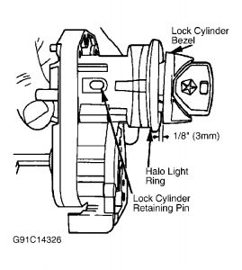

Remove ignition switch. With key inserted and ignition switch in LOCK position, depress lock cylinder retaining pin using a small screwdriver.
Rotate cylinder to OFF position.
Lock cylinder should now be unseated from ignition switch assembly.
Rotate cylinder counterclockwise to LOCK position and remove key.
Remove lock cylinder
Installation

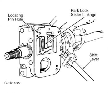

1.Install electrical connectors on switch assembly. Position park lock slider linkage in mid-travel.
NOTE: On column shift vehicles, shifter must be in PARK position. Ignition switch must be in LOCK position (column lock flag parallel with ignition switch terminals).
2.Mount ignition switch to column. Tighten mounting screws to 17 INCH lbs. (2 N.m). Install upper and lower steering column covers. Install tilt lever (if equipped). Reconnect negative battery cable.
3.With lock cylinder and ignition switch in LOCK position, insert lock cylinder into switch assembly until it bottoms. Insert key. Gently push in on key while rotating key clockwise to end of travel. Check for proper operation of ignition switch in all positions

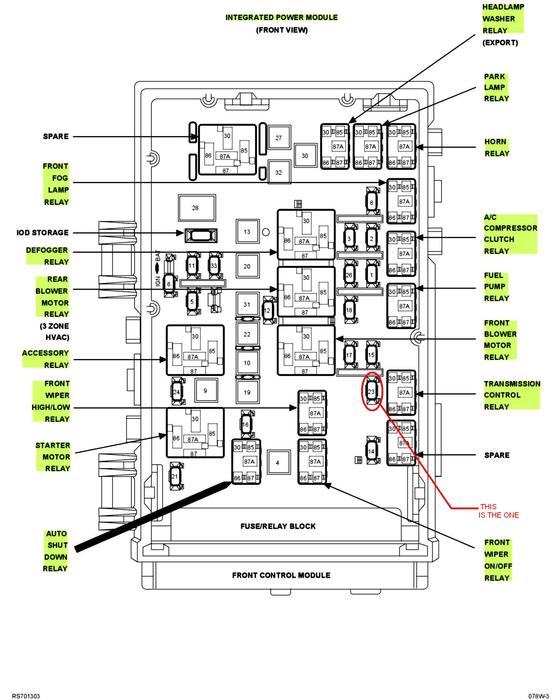

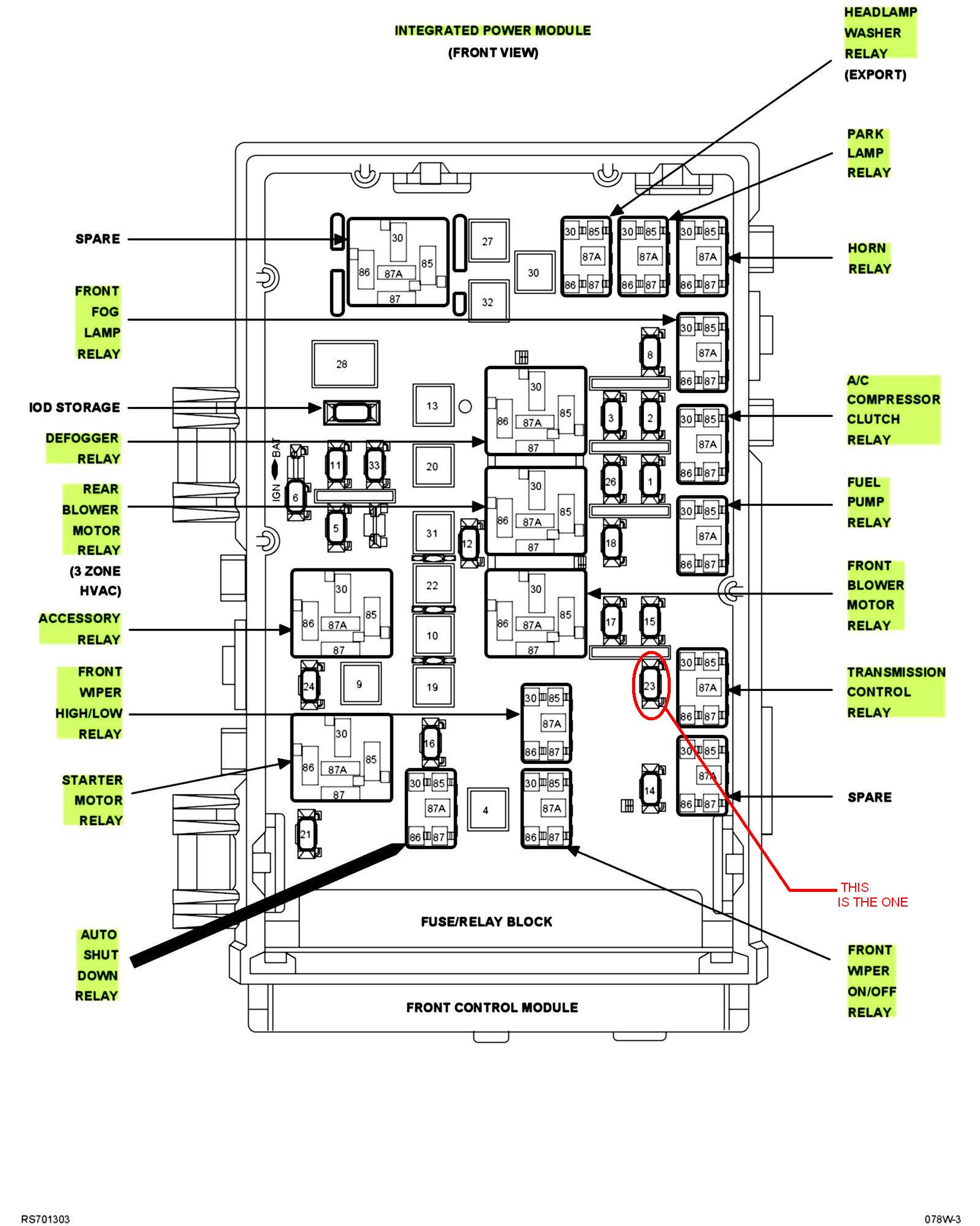

The ignition switch fuse (10A) keeps blowing. It only seems to happen when the vehicle is in drive. I can idle it forever in park, and it runs fine. As soon as I shift to drive and start going, it dies. I replaced the ignition switch, but the ignition switch fuse continues to blow
Wednesday, April 17th, 2019 AT 6:26 PM (Merged)
WRENCHTECH
  • 20,761 POSTS
The fuses are labeled by number. What number fuse is it.
+1
FREEMBA
  • 1,152 POSTS
That fuse also supplies power to the FUEL PUMP RELAY. If the relay is the problem it could cause the fuse to blow. Try swapping the fuel pump relay with an identical relay (in the same fuse box you should have an identical one). If the problem goes way then replace that relay.
If not, check for a wire with a bare spot on it in the large group of wires which lead from the power distribution box near the battery. These wires go under the battery box and it has been found that sometimes battery acid leaks on them and corrodes away the insulation allowing the bare wire to touch the frame causing blown fuses and other problems.
+1
UNAT2CARPROS
Fuse number 23 is the number
WRENCHTECH
  • 20,761 POSTS
Fuse #23 powers the ignition switch. That means that the switch or anything it powers can be the cause so you're going to have to start inspecting the switch and wiring looking for something shorted out. Overloads can be very hard to identify.

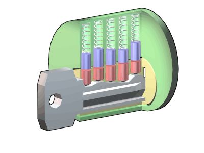

2-A.
The pins are not falling into place.
You kinda need to know how a lock works for this part.
Look at a key and you will see there are different depth cuts in it.
Those different cuts correspond with different length pins in the lock cylinder.
See how the red pins are of different length?
But with the key inserted, they are all even with the blue pins.
https://www.2carpros.com/forum/automotive_pictures/281878_Pin_tumbler_with_key1_1.jpg
When the red pins are held in the correct position by the correct key, the spring loaded blue pins are flush with the outer housing of the lock, and the red pins are flush with the inner cylinder of the lock
And thus the inner cylinder can be rotated.
https://www.2carpros.com/forum/automotive_pictures/281878_250pxPin_tumbler_unlocked1_1.png
If debris such as pocket lint, ear wax, or just plain old dirt gets into the pins and causes enough friction for the spring loaded blue pins to not be able to push the red pins back in place.
Then the red pins will be partially stuck in the hole for the blue pins and the cylinder can not turn.
Putting the key in the lock and then tapping on it with a small hammer may help until you have the chance to have the lock cleaned.
Do a search for the word "bump key" if you want to know more about how a lock cylinder works.

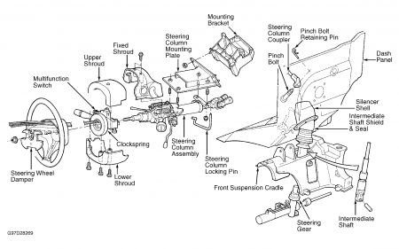

My 2002 Dodge Caravan ignition switch is stuck preventing it from starting. It was been doing this periodically, but I've been able to turn the key over (upside down), jiggle it, etc. And it will turn. This time not. Perhaps it has something to do w/ the temp outside (-20). Any ideas out there? Thanks.
Wednesday, April 17th, 2019 AT 6:27 PM (Merged)
DAVE H
  • 13,384 POSTS
If you cannot get the key to the RUN position you will have to drill it out i'm afraid !!
IGNITION SWITCH & LOCK CYLINDER
Removal
Disconnect negative battery cable.
Remove steering column cover retaining screws.
Remove parking brake release cable from handle.
Remove screws holding steering column shrouds and remove lower shroud.
Place key cylinder in RUN position. Depress lock cylinder retaining tab and remove key cylinder. See Fig. 5 .
Remove ignition switch mounting screw with a No. 10 Torx(R) tamper proof bit.
Depress retaining tab and gently pry ignition switch from steering column.
Disconnect electrical connectors from ignition switch and remove switch.
Fig. 5: Removing Lock Cylinder
Courtesy of DAIMLERCHRYSLER CORPORATION
https://www.2carpros.com/forum/automotive_pictures/266999_lock_8.jpg
Installation
Ensure the ignition switch is in the RUN position and the actuator shaft in the lock housing is in the RUN position.
Install electrical connectors to ignition switch.
Carefully install the ignition switch. The switch will snap over the retaining tabs. Install mounting screws.
Install upper and lower shrouds.
Install key cylinder (cylinder retaining tab will depress only in the RUN position).
Connect negative cable to battery.
Check for operation of ignition switch and key-in warning switch.

When you tried to turn the ignition sometimes the steering wheel lock gets caught. attached is how to remove the ignition switch. Make sure the battery terminal is disconnected
https://www.2carpros.com/forum/automotive_pictures/54223_ignition_switch_caravan_1.jpg
