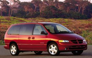

Transmission problem
2000 Dodge Caravan 6 cyl Front Wheel Drive Automatic 140000 miles
Got scanned codes P1698 and P0500. was told to change both speed sensors input and out put speed sensors.Did the change.but did not get any improvement.By-the-way ,the drivability fault is ,drives only in one forward gear can reverse ok .speedometer does not move at all.don't know i am travelling at 2, 5 or 25 mph !What step next ,should I change (PCM)or is there a fuse that controls power to PCM.Thanks for your help......

Suspect the transmission is going out, the sensor pick up on the difference between the input and out shafts not correlating becasue the internal clutches are slipping.
This is a common problem with these vans.
Please let us know happens so it will help others.
Best, Ken
