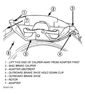

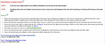

Here are the instructions and diagrams in order...
I will also email the instructions since they may not be very readable....
