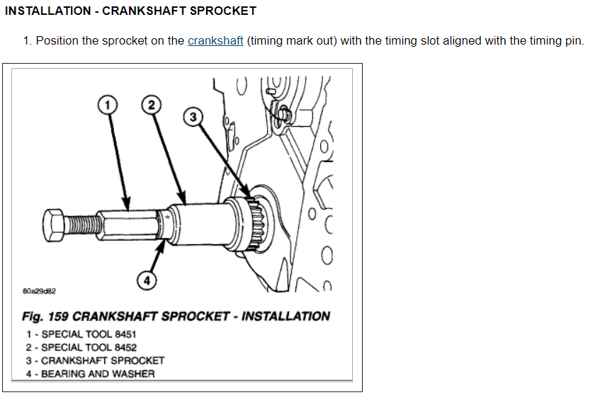

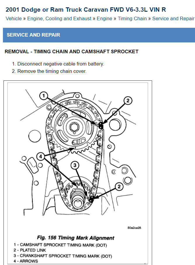

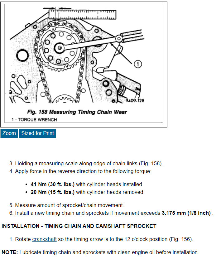

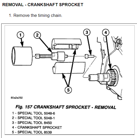

I would like to know if me grand caravan sport have a timing belt of timing chain thanks.
Thursday, February 21st, 2008 AT 5:19 PM
BMRFIXIT
MECHANIC
19,053 POSTS
Your car has a timing chain here are diagrams below to show you what you are in for when changing it out.
