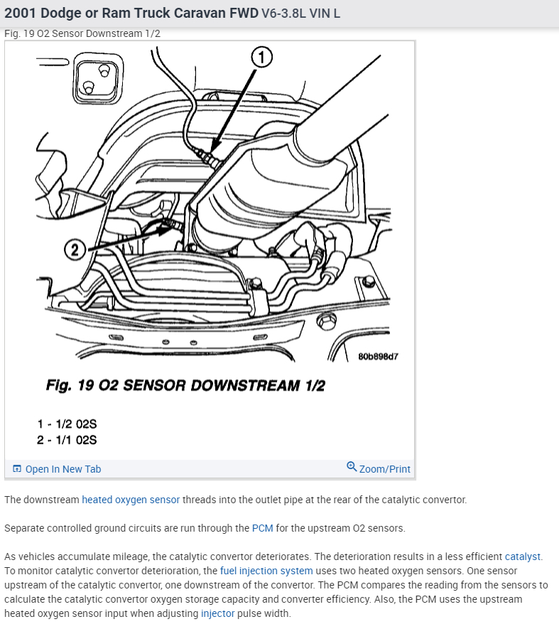

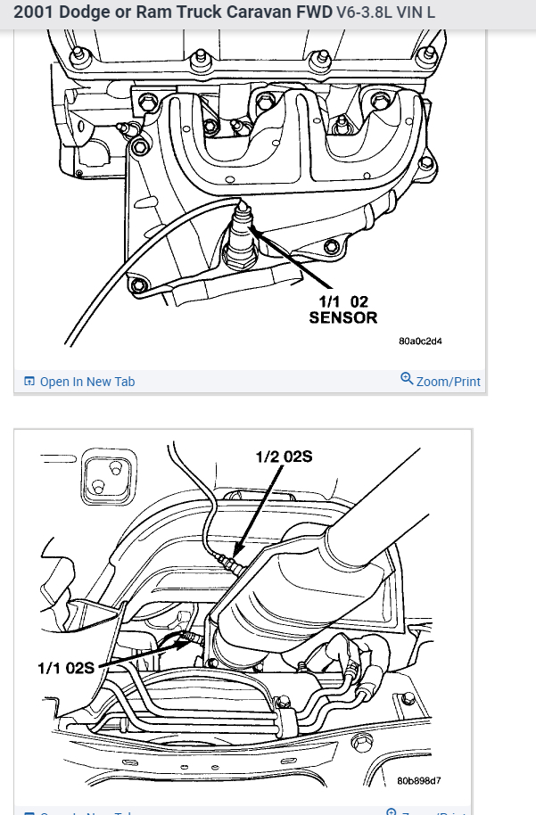

CH112063
  • 1,320 POSTS

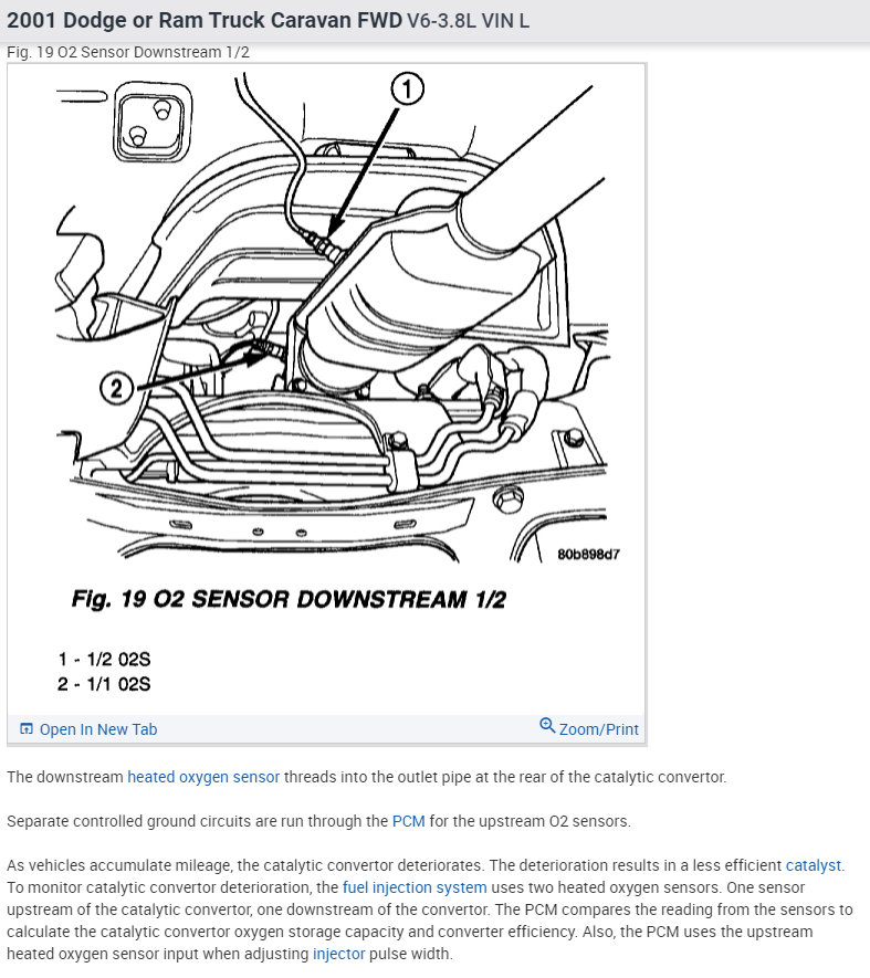

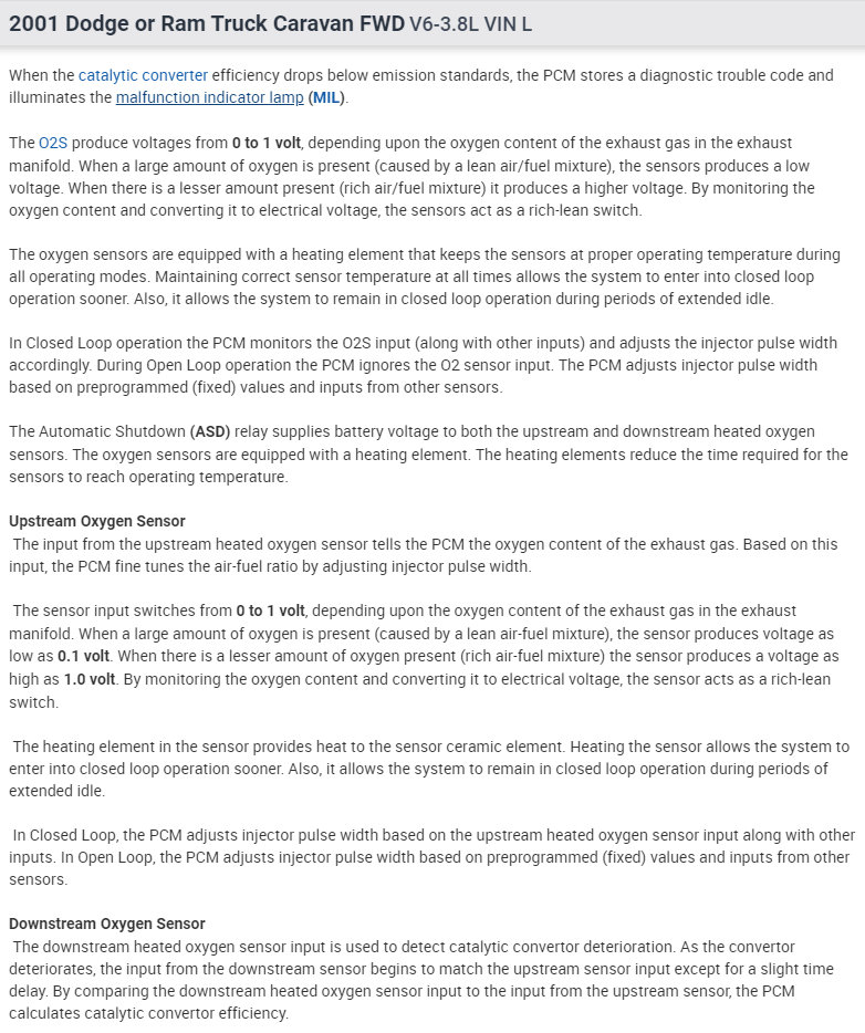

Upstream o2 sensor before catalytic converter, downstream o2 sensor in back of catalytic converter. This way the PCM can test he catalyst at all times when hot and in a closed loop condition. The scanner will always say upstream or downstream. OK
+5
Saturday, May 8th, 2021 AT 5:37 PM
CH112063
  • 1,320 POSTS
Upstream o2 sensor in front of cat. Converter downstream o2 sensor is behind cat converter. The PCM compares these two to check the converter at all times. Try a different scanner, it will specify which one is not giving a proper response while hot in closed loop. OK be careful

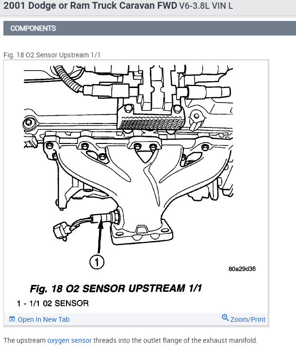

JOHN_H
The OFF-ON, OFF-ON, OFF-ON trick worked! It showed P0135 (upstream 02 sensor) is faulty! .I ordered an upstream o2 sensor from RockAuto. Since I heard it was a real pain to replace this one, I am going to bring it to my favorite garage for them to replace it for me (plus some other work of course). I will let you know if this works.

JOHN_H
Yup, this worked! I just got the van back from my mechanic. I purchased the Denso O2 front (upstream) oxygen O2 sensor from RockAuto for just over $50 and paid my mechanic $50 to replace it. So, I now have it all working for $100. Much cheaper than having my dealer do it - I believe the sensor alone was $100.
Thanks for all the help!

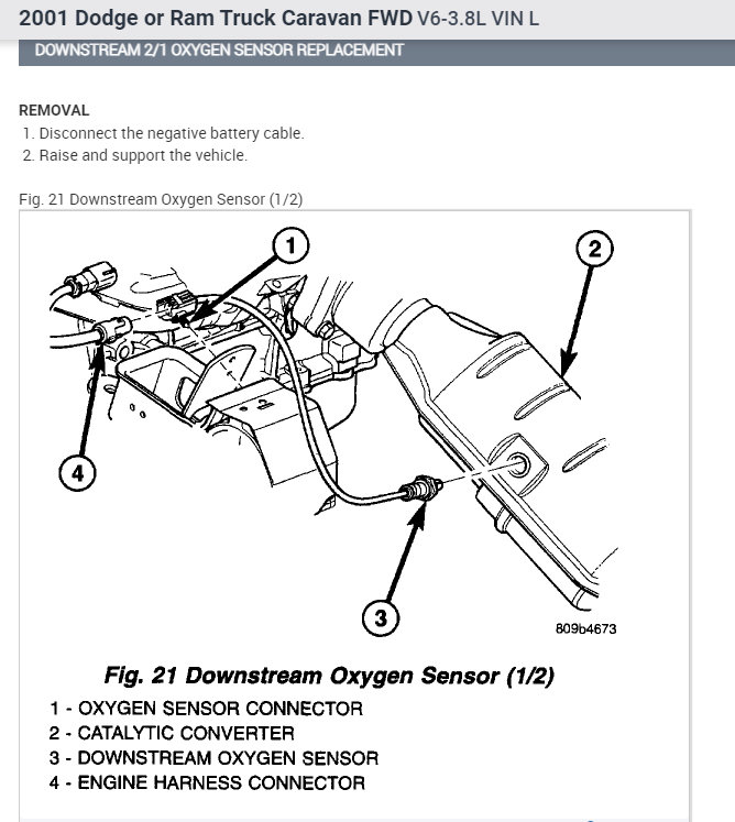

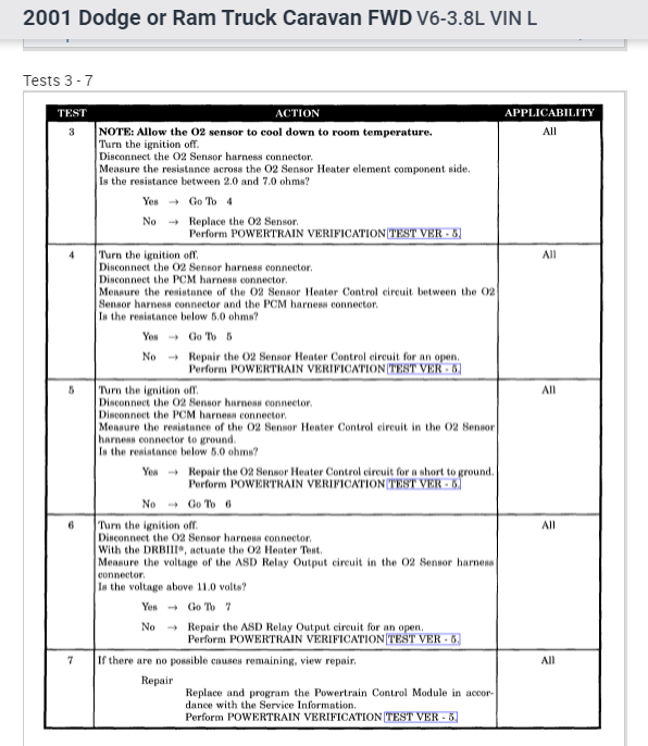

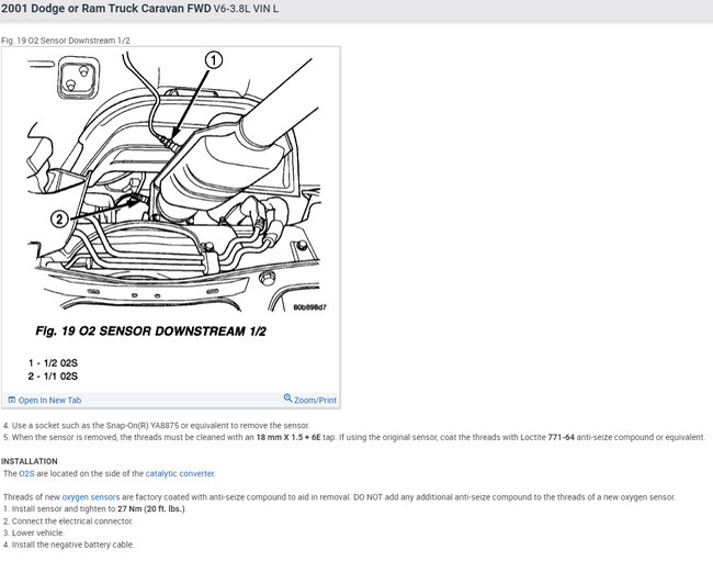

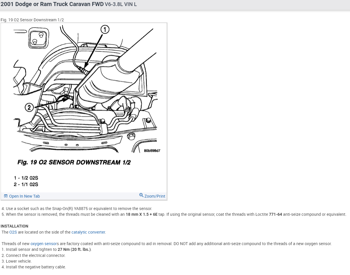

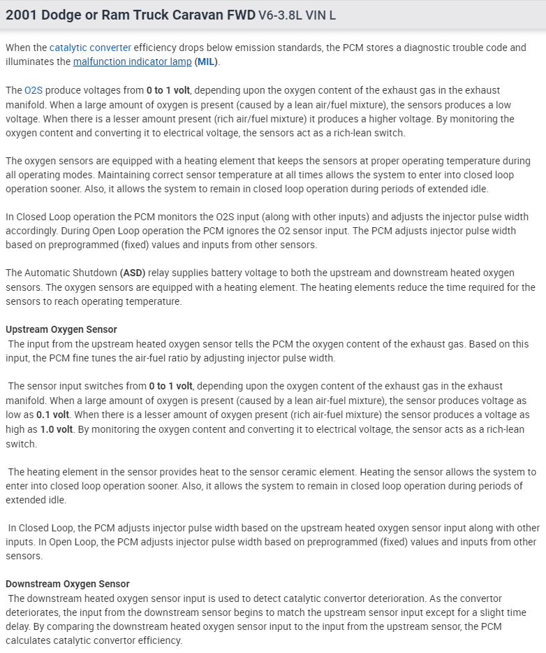

SQM
  • 6,383 POSTS

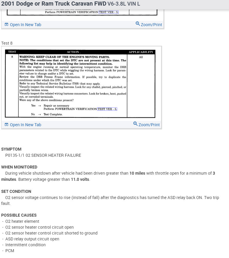

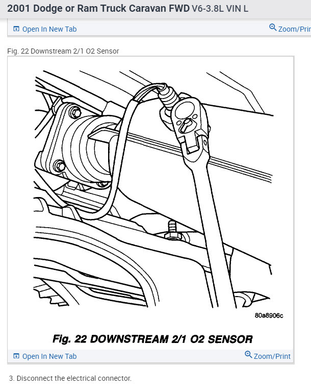

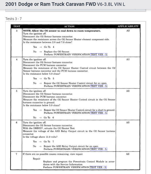

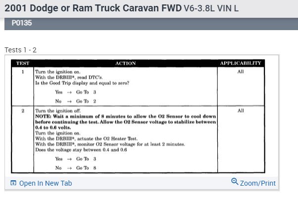

I have attached the oxygen sensor replacement procedures for anyone else might be looking to replace them.
Also included troubleshooting steps for the code P0135.
https://www.2carpros.com/articles/how-to-replace-an-oxygen-sensor
