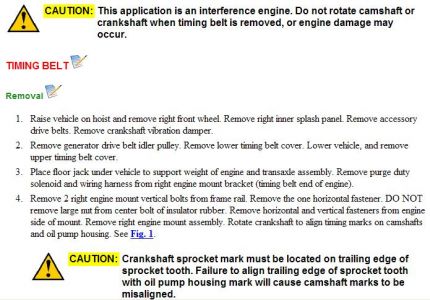

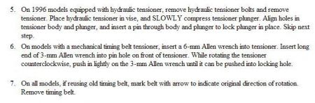

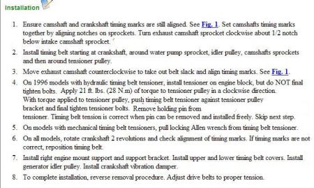

I need the specs to replace a timing chain

Your vehicle is equipped with timing belt not a chain. replacement procedures are below..
FIG. 1
