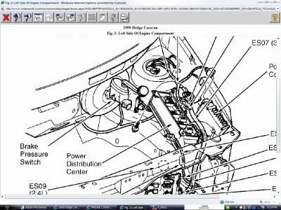

check the relay in the power ditribution center under the hood on drivers side. also if you have a test light hook it up to the horn lead, press the horn, does it light? if yes the horn needs to be changed...check horn fuse in the car...
https://images.2carpros.com/forum/automotive_pictures/62217_pdc_1.jpg

I have checked the horn switch & it indicates working. Switched horn relay with adjacent relay, no horn. Checked fuses, no bad fuses. Pulled horn, horn works. No power to horn. Any ideas?
PS: Airbag and low wash indicator lights have been on for several weeks. No obvious problems under steering wheel cover.

Welcome to the forum, there is a horn relay in the power distribution center, under the hood. Use a testlite on the relay terminals, with relay unplugged, two terminals should be hot all the time. In the same electrical box, fuse 20--20 amp is for the horn.
The problem is usually the wiring circuit in the steering column, maybe you'll get lucky and it's just a fuse?
