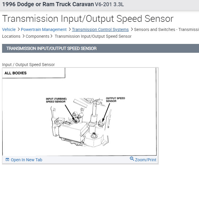

Transmission will not shift out of low gear when its at running temp. After it is shut off for 10-15 minutes and re-started it shifts okay

most common failure and I would suspect tranny solenoid pack and or speed sensors
let me know what you have for codes

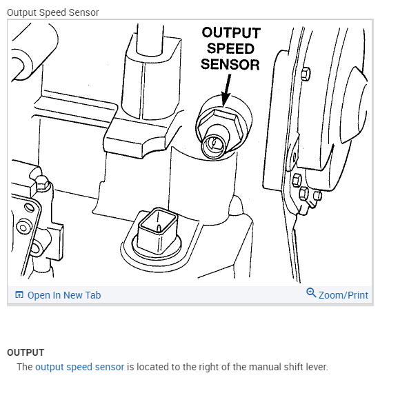

The output sensor was bad all fixed.

The output speed sensor is located to the right of the manual shift lever.

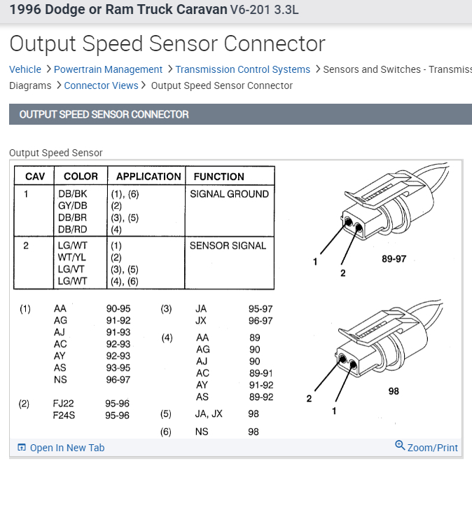

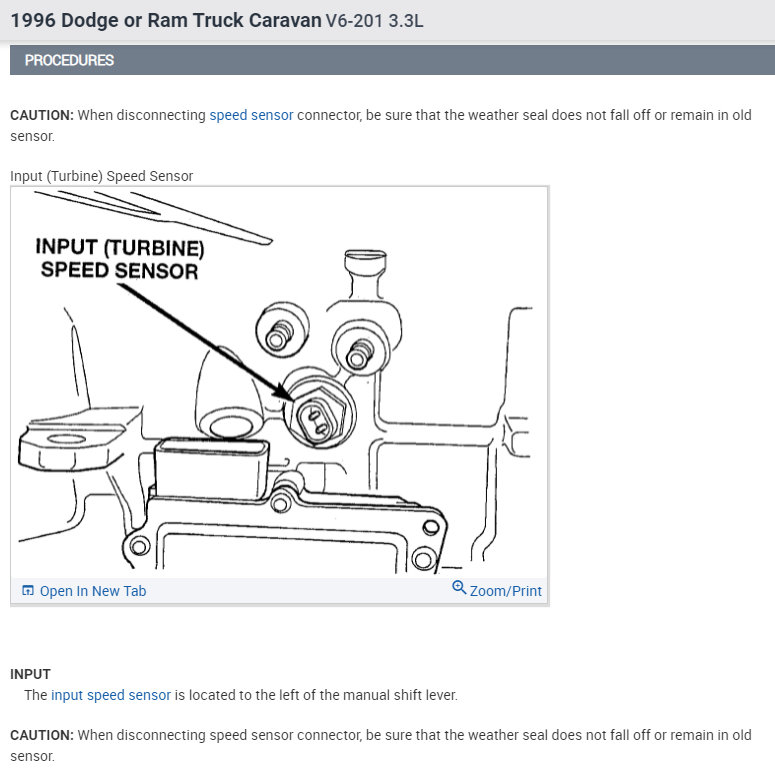

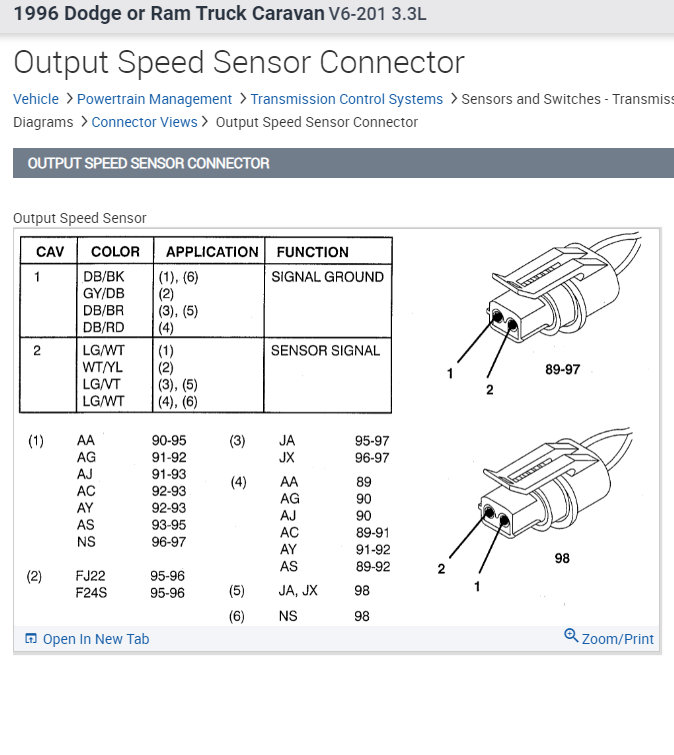

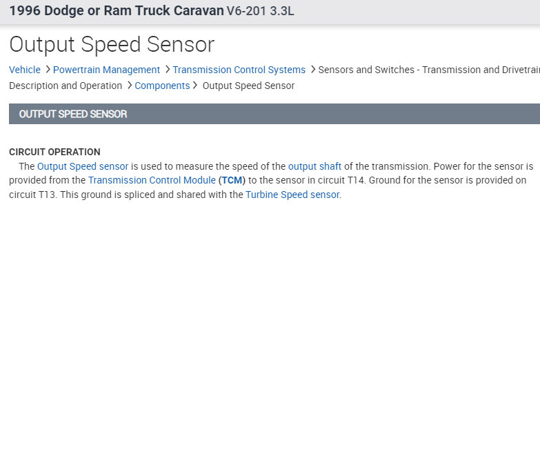

I have attached the output sensor replacement instructions below for anyone else who might be having similar issues.
Any questions, please let us know.
