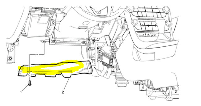

The short - My defroster is not blowing to the glass. I then observed that I could not force the air away from the dash vents using any of the mode buttons.
I found the actuators under the dash (driver's side) and they appear to be working, at least moving the gears that I could see. II removed the large white gear wheel, and the two levers fell out in pieces. I purchased the levers and attempted to reinstall, but I assume that there is a way to zero or index the gears, and a designated groove for the lever knobs to ride in on the back of the white wheel gear.
There is an inner and an outer groove on the white gear. I am trying very hard to DIY this job but as you know it is a challenge, just in the location of the repair alone. I hope that you can provide guidance on the way this is to be reinstalled and maybe provide insight on a way to do this without laying under the dash, using a small mirror. Or, If I am way off base, a course correction.

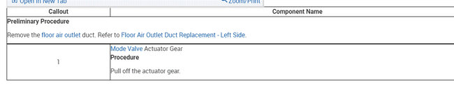

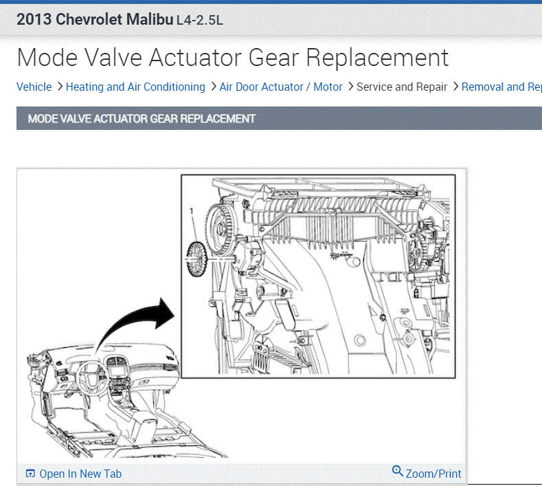

If it is the gear you are replacing, you should be able to access it by removing the left side outlet air duct. See pic 1 below.
As far as replacing the gear, pics 2 and 3.
If it is the cam gears that fell out, the only way I know to install them properly requires the HVAC module to be removed. If that is the case, let me know. Also, let me know if this vehicle has automatic or manual climate control. The info below is specific to the manual.

Thank you Joe! It is the 2 cam gears that were broken and fell out. I have been trying to get them back in with the air duct removed gaining access under the dash but lighting, mirrors, and hands larger than a toddler make this quite an endeavor. I researched a bit on removing the HVAC Module and this looks to be not a DIY job, requiring evac and recovery?

I totally understand. There simply isn't enough room for a person to work on it. As far as the removal of the module, it does require the removal of the following:
Inst panel cluster
inst panel support
door seal trims
brake and accelerator pedals
inst panel tie bar
inst cluster panel
inst cluster support
And the list goes on and on. LOL If you want to try it yourself, I will be happy to get you all the directions.
