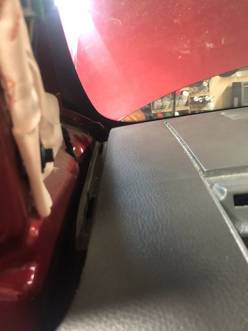

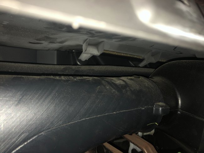

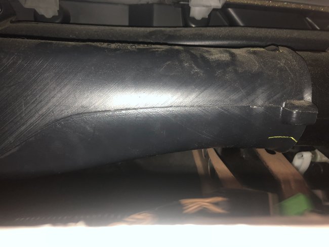

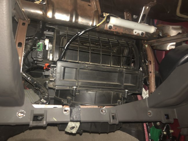

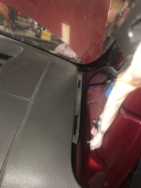

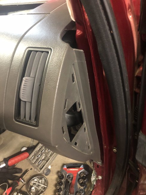

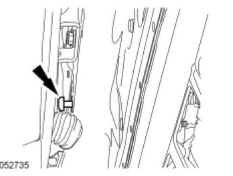

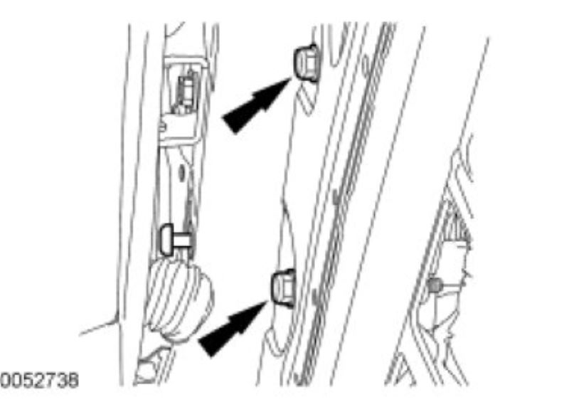

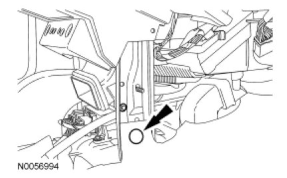

I had to replace the defrost/panel/floor mode door actuator on my vehicle. It is a long job because of removing the whole dash. I followed the instructions from the repair manual. (Chilton and Cardiagn) The problem was I could never get the dash totally off, it always felt like it was connected somewhere. I was able to replace the actuator and I am trying to put things back together, but I can't get the dashboard/instrument panel back into a flush position. Again, it is very difficult to move and it feels like it is attached to something. I have got about an 1/4" - 1/2" gap between the panel and the mounts it needs to attach to. The dashboard/instrument panel is one piece and I can find no information on it anywhere. I can see that the dashboard/instrument panel is attached with "clips" (more like a tapered post into a hole) but I was unable to remove the dash. Help! What did I miss or what am I doing wrong?

Good morning,
From the sounds of it, the ducts that connect to the dash from the firewall may not be seating correctly.
Can you post a picture of what you see so I can see what you have?

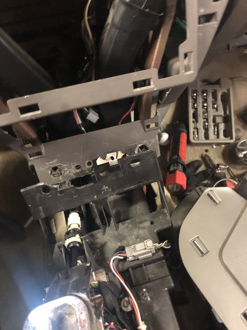

Here are some pictures. I tried to show the clips that keep it attached. The ones that can be seen are above the glove box. The problem is one that I saw seemed to have a nut attached at the end and it was pretty impossible to get off. I have a few more pictures, but I am converting them from my iPhone format to. Jpg so I can upload them.

Does this work?
Thursday, November 29th, 2018 AT 9:59 AM
Got them.
Looks like it may be an angle issue getting it to sit correctly. Try lifting it up and see if it seats in any better.

Thank you. I have tried that, but I will try from different angles. I also will get some help - maybe two people maneuvering it will make it work
Are those clips/posts usually attached with nuts? I thought it was supposed to "pop out" - I was even using trim tools, but it was not until I used a small mirror did I see the nut. It seemed impossible to find any information at all on how to take off the 2009 Edge dashboard. All the other years seem to have a panel or small area that could be popped out to receive the screw. I have the Chilton manual and it stops (like everything else) at the instrument panel. It just says to lift it off. Do you know if there are pictures or directions anywhere that I can access?
Thursday, November 29th, 2018 AT 10:49 AM
Yes there is. Bear with me. There are many and will have to copy. Will take a bit.

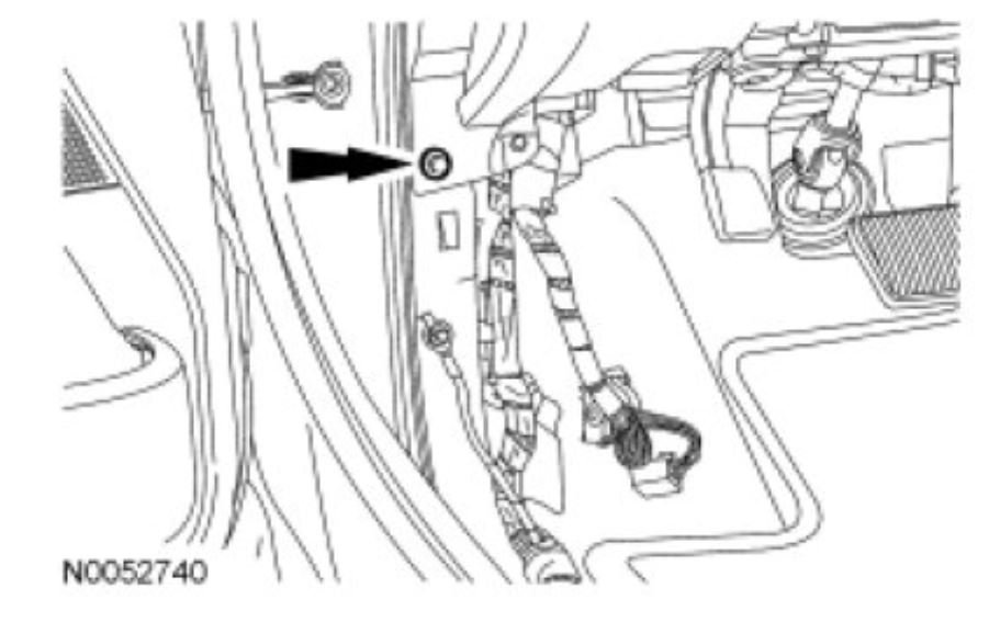

Procedure
Instrument Panel
1. Remove the driver seat.
2. Remove the floor console. For additional information, refer to Console - Floor See: Console > Removal and Replacement > Console - Floor.
3. Remove the steering wheel.
4. Remove the weatherstripping from the front door openings near the instrument panel.
5. Remove the LH and RH instrument panel side trim panels.
6. Remove the LH and RH A-pillar trim panels.
7. Remove the LH and RH cowl panels.
8. Remove the steering column opening trim panel.
- Remove the 2 steering column opening trim panel screws.
- Disengage the steering column opening trim panel from the retaining clips.
- Disconnect the electrical connector and hose, if equipped.

31. Remove the upper cowl panel grille.

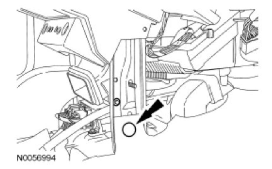

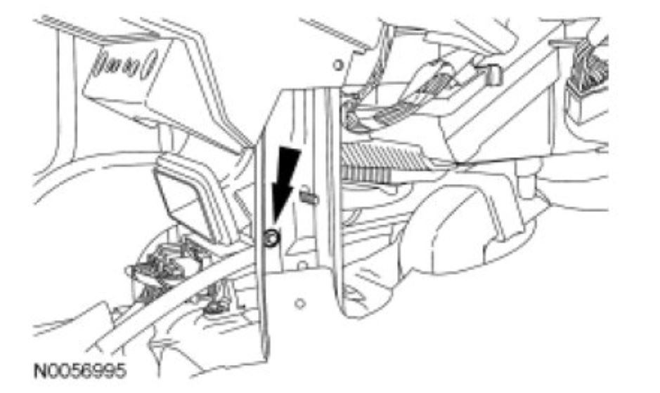

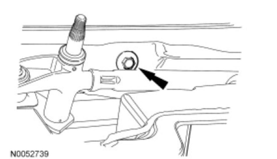

32. Remove the bolt from the front of dash.
- To install, tighten to 20 Nm (177 lb-in).
ImageOpen In New TabZoom/Print

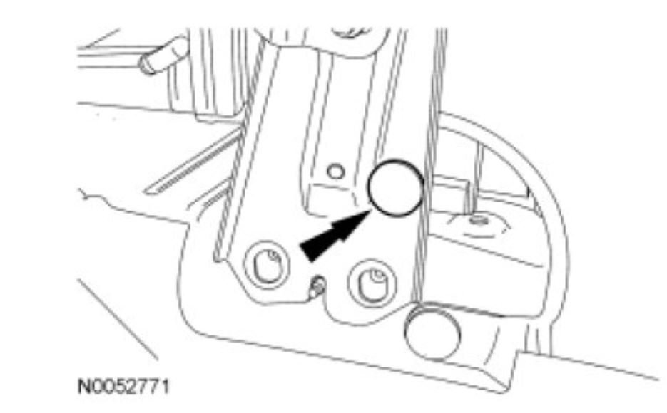

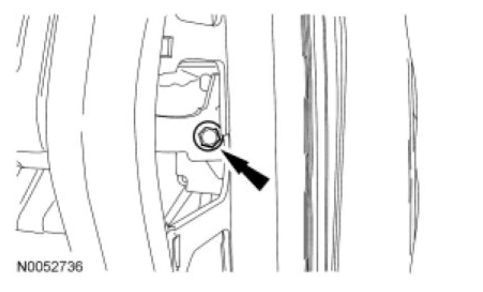

33. NOTE: The Torx head bolt is not completely removed. The bolt is pulled outward far enough to allow for clearance when removing the instrument panel.
Completely loosen the Torx head bolt from inside the LH door opening.
- To install, tighten to 30 Nm (22 lb-ft).

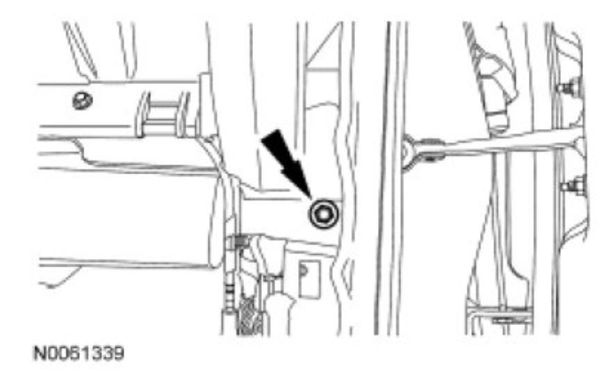

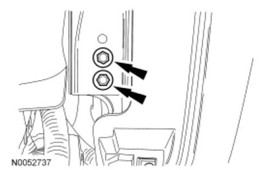

34. Remove the 2 LH instrument panel bolts from inside the LH door opening.

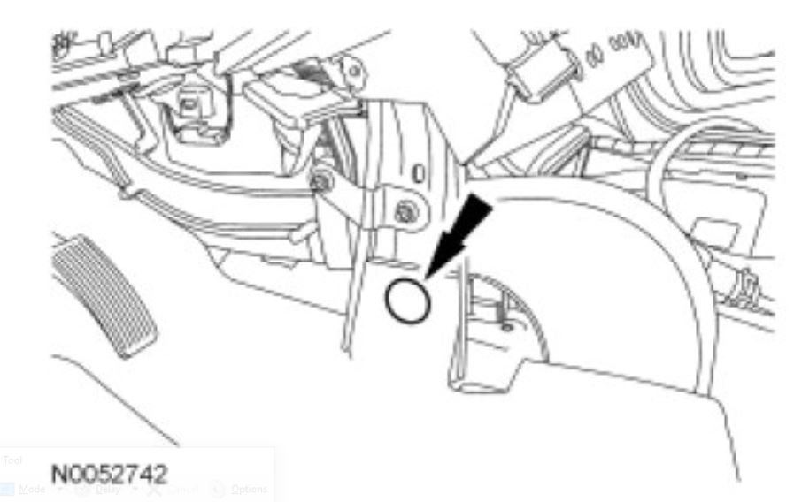

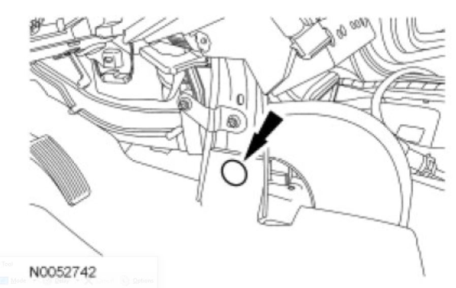

35. Remove the 2 instrument panel-to-steering column bracket bolts from the bracket under the steering column.
- To install, tighten to 22 Nm (16 lb-ft).

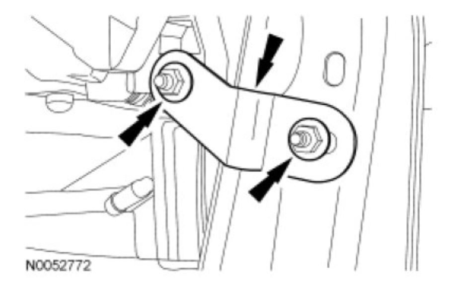

36. Remove the LH instrument panel-to-body bolt.
- To install, tighten to 7 Nm (62 lb-in).
37. Remove the bolt from the RH instrument panel.
38. Remove the RH instrument panel-to-body bolt.
39. NOTICE: To avoid damage to the instrument panel, this step requires the help of an assistant.
NOTICE: Make sure that all electrical connectors and wiring are not hindered before removing the instrument panel or damage to the components may occur.
NOTE: Rotate the instrument panel as necessary to remove the instrument panel from the vehicle.
Remove the instrument panel.
40. NOTICE: To avoid damaging the instrument panel, the aid of an assistant is required when positioning the instrument panel to the vehicle.
NOTICE: Make sure that all electrical connectors and wiring are correctly routed when installing the instrument panel or damage to the components may occur.
To install, reverse the removal procedure.
