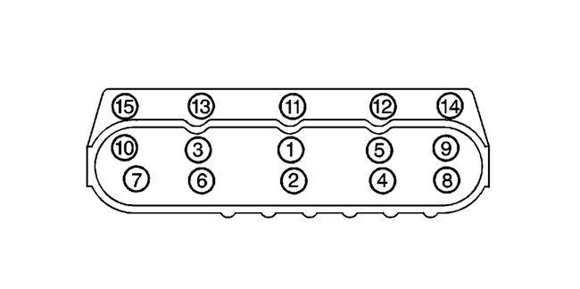

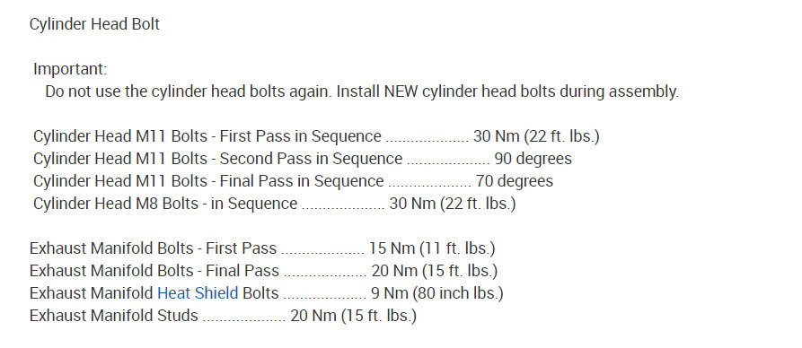

What is the cylinder head bolt torque on the vehicle listed above XL Denali?
Saturday, June 12th, 2021 AT 11:07 AM
MECHANIC
52,796 POSTS
Good afternoon,
I attached the torque for you for the bolts.
Make sure you use new bolts. The old bolts stretch and cannot be used. If you use them, the head will come loose and it will create many issues.
