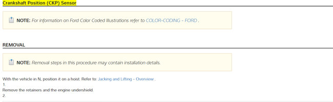

Check engine light is on. Diagnosis indicated code for crankshaft sensor.

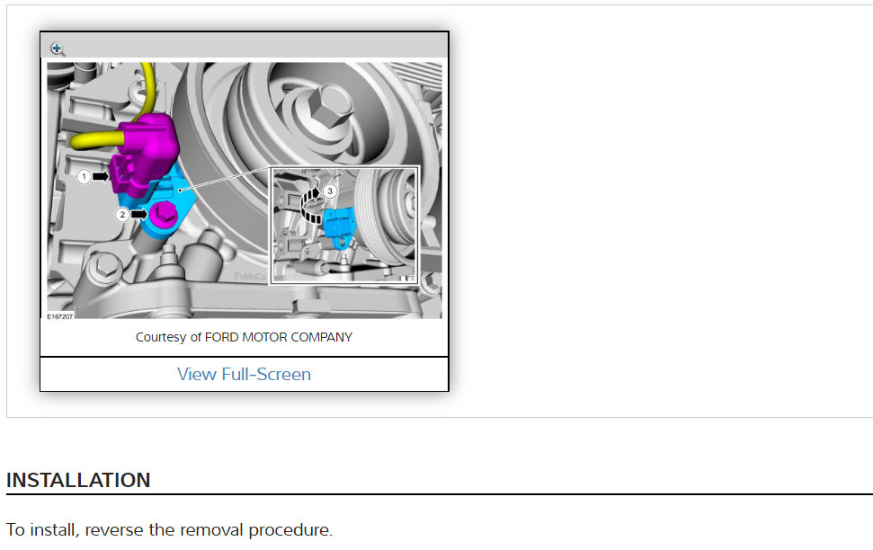

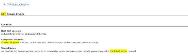

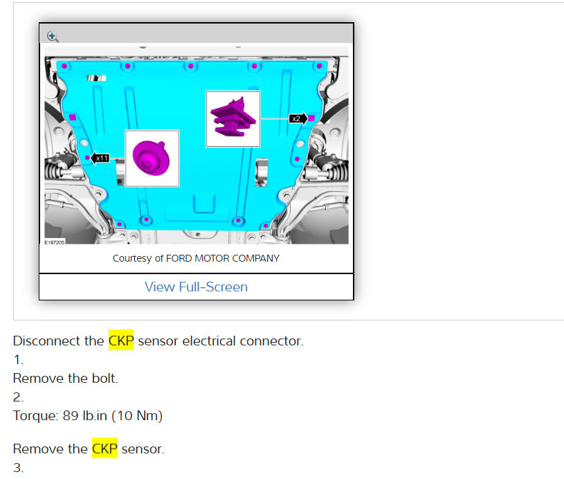

Hi Driversltd, my name is Alex and I will be helping you. Here is a couple of helpful links and some instructions on where and how to replace your crankshaft position sensor. Thank you and let us know if there is anything else we can help you with.
https://www.2carpros.com/articles/how-a-crank-shaft-angle-sensor-works
Images (Click to make bigger)
