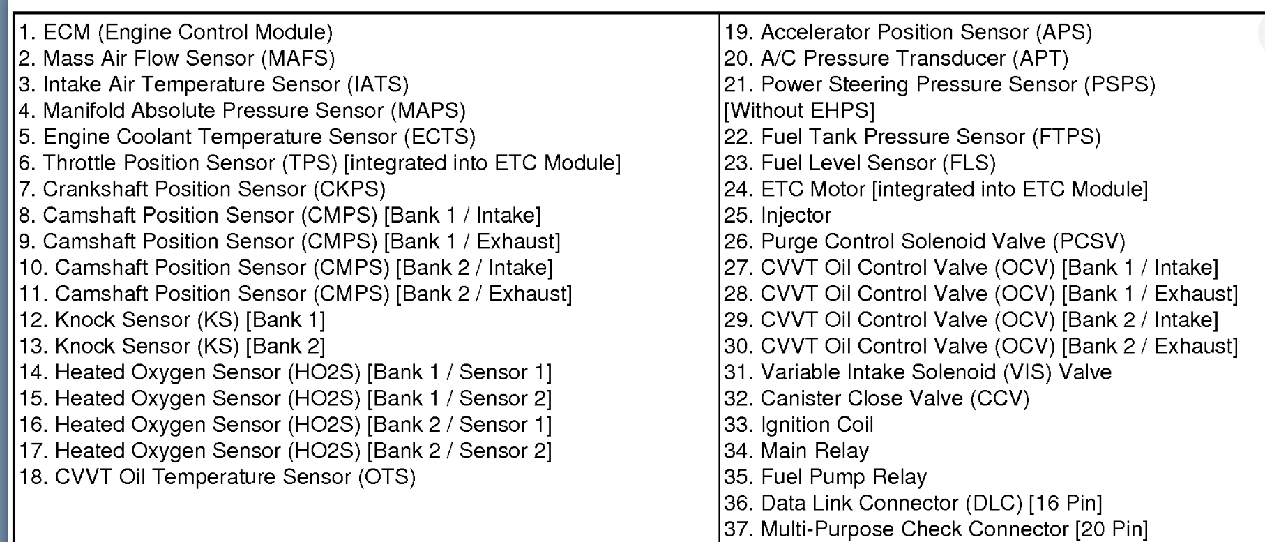

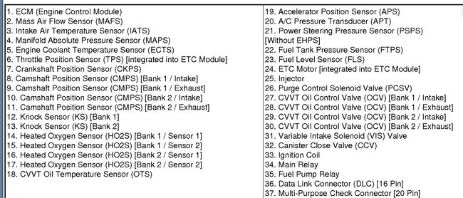

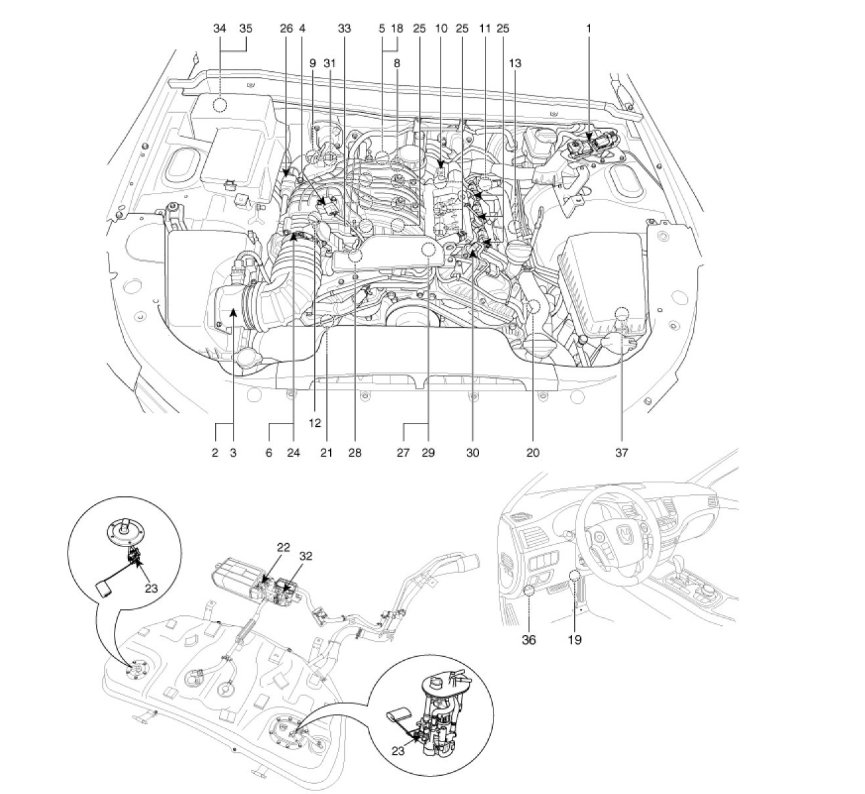

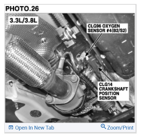

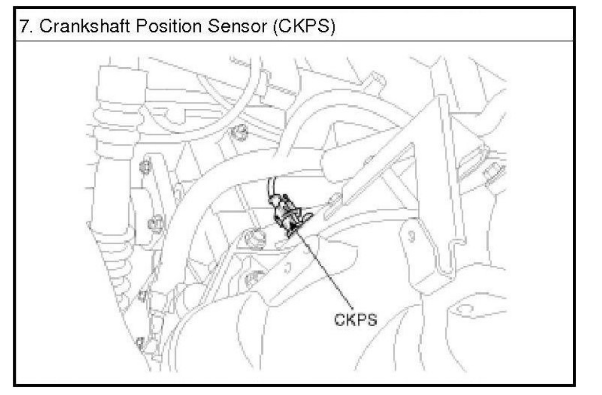

Crankshaft position sensor location?
Friday, August 12th, 2022 AT 9:03 AM
KEN L
MASTER CERTIFIED MECHANIC
55,481 POSTS
It looks like the crankshaft sensor is at the rear of the engine. I found diagrams of its location and I have added them to the images below. Check out the diagrams (below). Please let us know if you need anything else to get the problem fixed.
