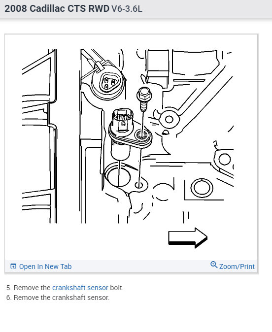

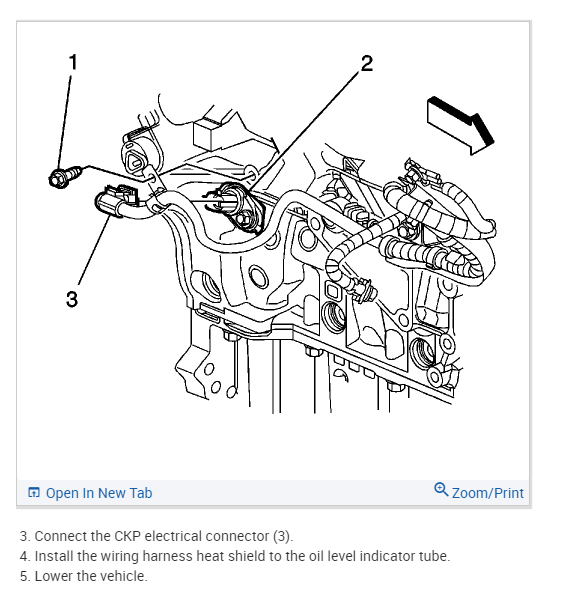

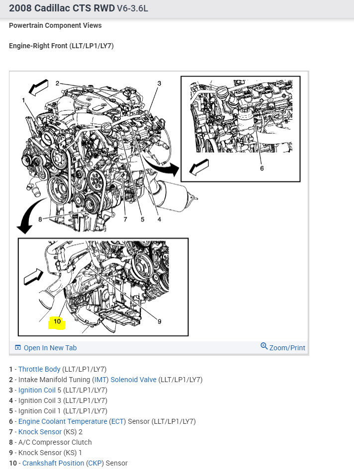

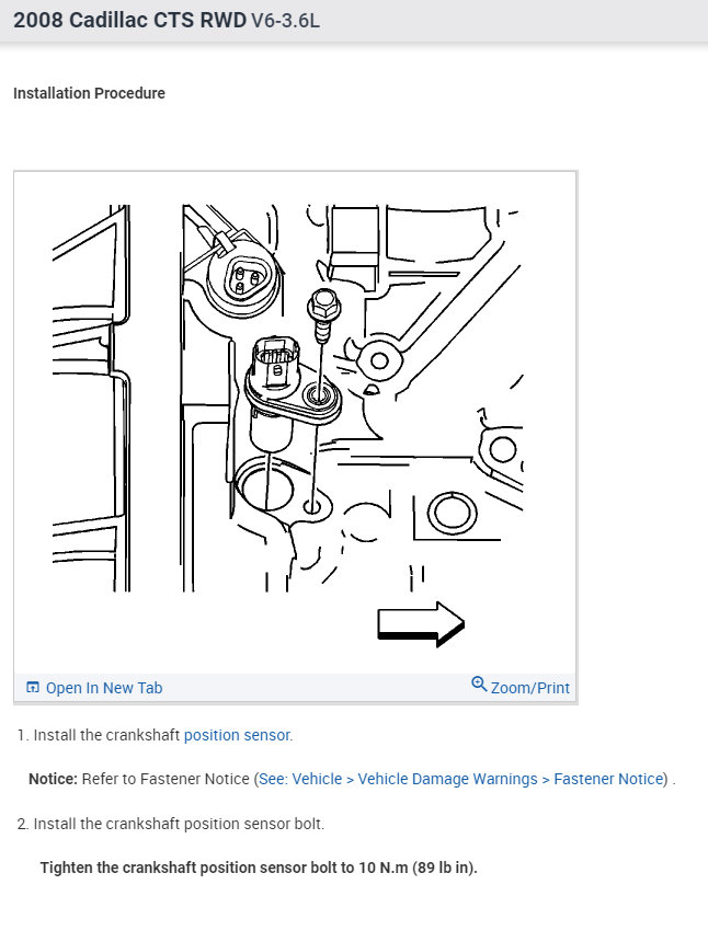

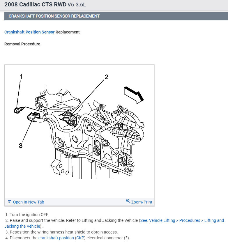

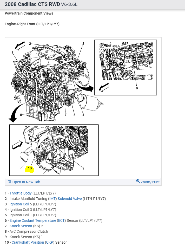

Where is the location of the crankshaft position sensor on the car listed above? Diagrams please.
Thursday, June 30th, 2022 AT 5:35 PM
SQM
MECHANIC
6,383 POSTS
The crankshaft position sensor is located on the lower part of the engine on the passenger side (see attached diagram).
Let me know of any questions.
