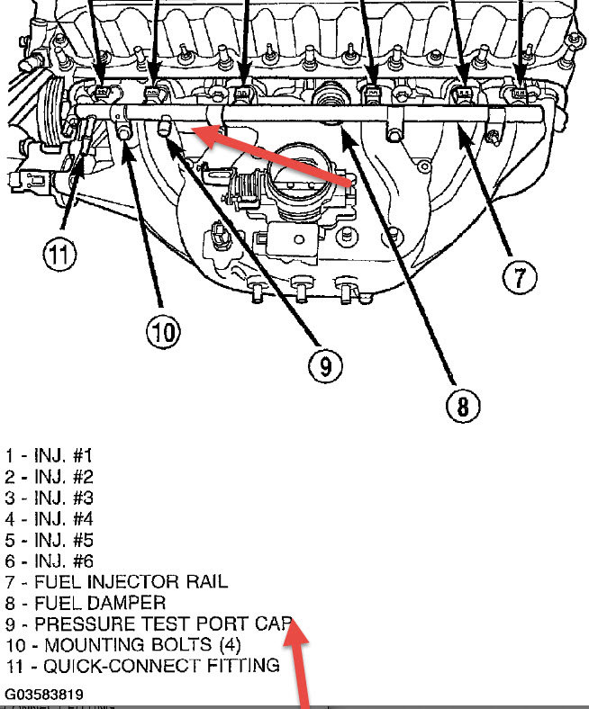

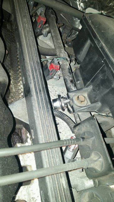

HMAC I can't find a Schrader valve I found this on the rail my buddy says that's a fuel damper where else would the Schrader valve be to check the PSI
Mar 24, 2016 at 5:15 PM
HMAC300
  • 48,601 POSTS
see pic should be 43 psi +-5psi. also try resetting security system first if no manual look on line on how to reset
Mar 24, 2016 at 5:21 PM
HMAC300
  • 48,601 POSTS
see pic

I will check again in the day light but I been all over the rail it's not where the pic is...can it be someplace else possible
Mar 24, 2016 at 5:42 PM
HMAC300
  • 48,601 POSTS
no if it is not there where specified then you will need an adapter
Mar 24, 2016 at 5:45 PM
DON30ALD1
  • 13 POSTS
HMAC is there another way to check the psi if no Schrader valve can I check it at the gas cap?
Mar 24, 2016 at 6:26 PM
HMAC300
  • 48,601 POSTS
no you need an adapter for the fuel line to attach a gauge or a pro can do it with a scanner with no adapter.
