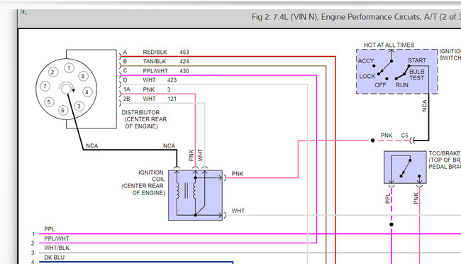

Engine turns, no spark, no fuel. Just replaced plugs, wires, cap, rotor, and coil.

Unfortunately after some more research. This truck has a 1993 7.4L in it. So, new question is.... is there and where is the crank sensor located on a 1993 454 small block?

The crankshaft sensor is inside the distributor. Please check out the images below.

Thank you. Great information, very helpful. Replaced and truck started and runs great.
Appreciate your time.
