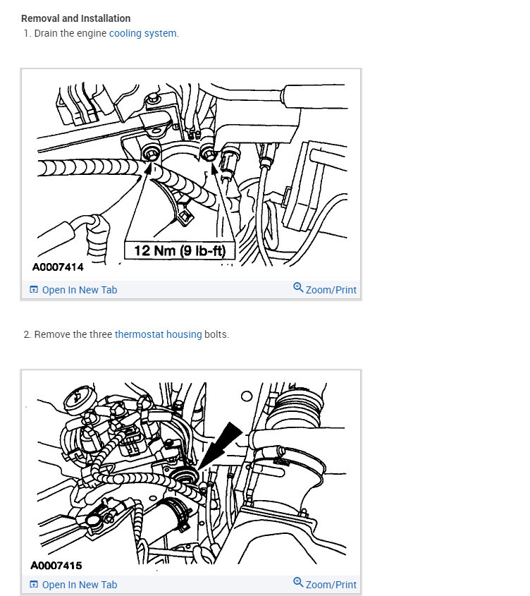

I can't find location of thermostat the car listed above ls premium.

Follow the upper radiator hose back to the hosing shown and you will find the area shown in these drawings.
Let me know if you still can't find it and we can get more detail. Thanks
